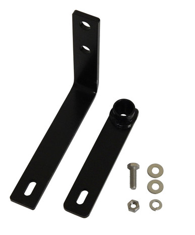

here are sources for the anti-rotation bracket for a small block
or here
or use the stock volvo bracket or make your own.
