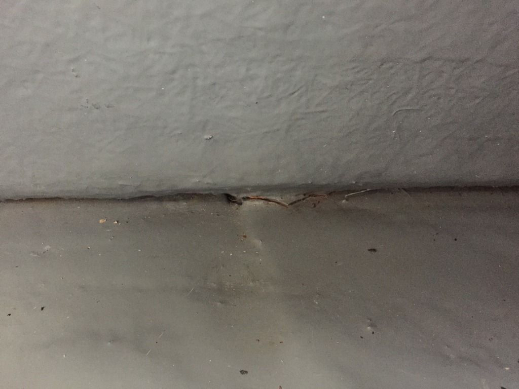

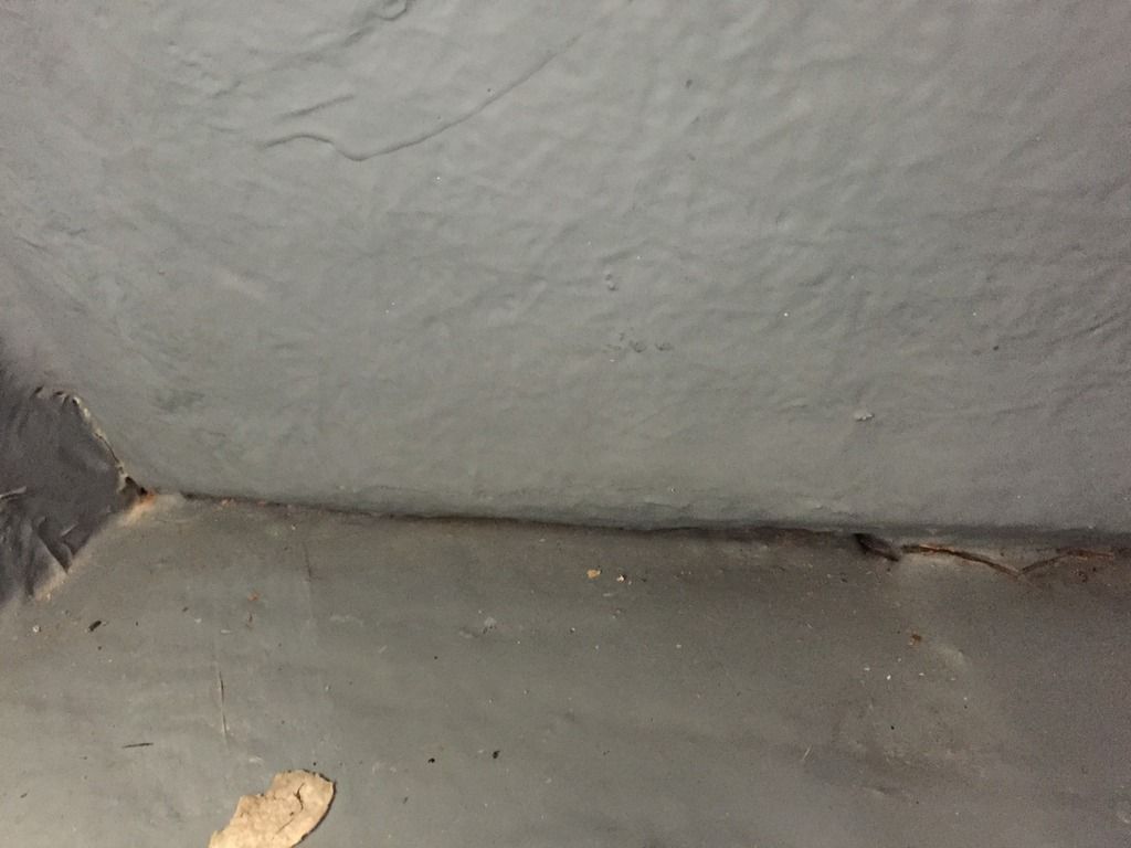

Looking for some advice towards how serious the crack is inside the v-birth storage where the bulk head is and v shape hull meets. I was told by my surveyor that it is not structural and obviously is not taking on water from it. here is a picture of it. I was told that it is something that needs attention but is not that serious. Looking for advice on how to repair it. Thank You , picture are in link.

I've copied your pics here so the members can more readily access them..
As far as the repair goes, I'd recommend using a Dremel to grind it out, clean it well with acetone, and then just use some 5 minute epoxy and thicken it with some talcum powder to make it like mayonaise and then putty knife it place

ahh , thank you. How deep is too deep? I dont want to grind into the bottom of the boat by accident. How thick is that area? Thanks

I'd use the V-Grooving Bit and git rid of the "Glob" that's there and back into the crevice. The Gelcoats about the thickness of a penny and then the glass will be about that thick too! You want to get just a bit into the glass and you're good to go!!:stupid:

What's your opinion on the crack? Nothing major? A quick patch should fix her right up? There is another crack about that size but its way deep inside there and could not get a pic of it.

Well, I'm not the consumate EXPERT but based on it's location, I'm going to agree with the surveyor and state it's only cosmetic and nothing be concerned with. You can fix it or leave it as is.

The surveyor said the same thing , he is no expert in determining what type of damage but recommended for a fiber glass specialist to take a look and recommend a way to fix it. I think its something that does not require paying a fiber glass guy 100 bucks for an hour of his time to inspect it.

It is a little hard to tell exactly what we are looking at because the pictures are so close. But . . . the area of the crack does not look like it was in tended to be tabbed to the hull, merely resting on the hull. So, in that regard, the surveyor is probably right that it is superficial and an easy fix.
