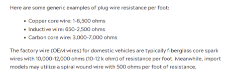

Does anyone know what the correct spark plug wire resistance should be? These wire came in a cheap ebay tune up kit so they may be bad.
With plug wires a adopt a 'if in doubt, throw it out' policy.
Local car shop, 8mm silicone wires, you can't go wrong.
Chris......
