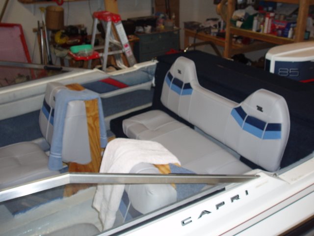

I am changing the seating layout on my current project from back-to-back lounge seats to two buckets seats and a bench.
I like the style/shade of the seating part itself. So I would like to convert to single buckets on a swivel with a storage box under each seat.
Has anyone done this before? If so how?
Old seats:
I am thinking of 3/4 plywood for the base and back support and 1/4 plywood L-shaped bracing (matching the contour of the seat foam)
Then vinyl sprayed to whatever color I want :D

You have a good idea, but just use 1/2 for the back and sides and at least 3/4 or 2 pieces of 1/2 glued together for the L shaped bits. I'd use cloth and resin on the L shaped pieces because there will be a lot of stress on those parts at the elbow (think about someone standing up and grabbing onto the top of the seat for balance when a big wake goes by). I went by with something like that temporarily last year.

MAXXIE - I wanted to go with swivel bases, but, that would have added to my overall cost. (I was really trying to do a budget build.) My main concern, and the reason I didn't go with swivel bases, was that the floor wouldn't have taken the stress of the bases. They would have lasted a season and then most likely ripped out. (That was feeling anyway.) The floor would have needed reinforcing to have done it right.
Those bases would be nice, but I think they need about 6 more screws.

I would also like to convert to a bucket for the helm but am affraid to pull the back to back box up! the deck is solid but don't want any suprises I was thinking something along the lines of mounting a swivel on the back to back box and using part of the old seat pad as a cusion lid combo for what's left in the rear. The disadvantage of the B to B's are to low,awkward and take up allot of room.

Rather than pull the bases 'Up', just take a sawsall and cut them flush with the floor.

The only thing with that is that I want the hieght because I always find myself sitting on the backrest of the BtoB and the base would provide the perfect platform so to say for the captains swivle chair and also provide some storage for life vest's and a small seat in the rear I think I can pull this off with a pc, of 3/4 and some strong hinges this way I can lift both the seat and captains chair if needed. Man! this makes me want to yank the girl out of storage and start working

Actually, that's why I built my back supports like I did. I end up sitting up there as well. The master plan included adding padding to the wood 'top' for sitting up on.
