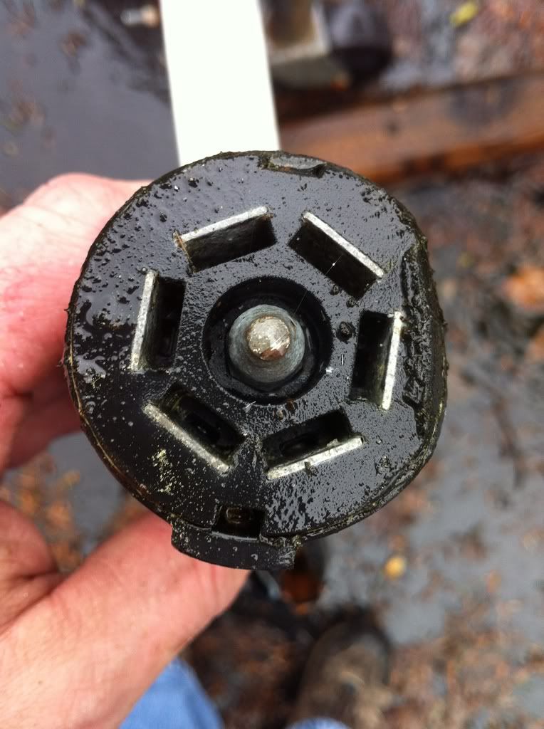

I have this connector on my trailer currently
I want to change it to a basic flat 4. Can someone point me to a basic tutorial?

The connector you are showing is called an "RV" connector. Is the tow vehicle equipped with the match to this? How many wires are coming out of the trailer connector? There should be a White (Ground) Brown (Tail lights) Green (Right turn) Yellow (Left turn) if you have electric brakes on the trailer there could be a blue or red wire to operate them. If you tow vehicle is equipped with an RV connector the that's as good as it gets and i wouldn't change a thing. If the tow vehicle is equipped with a flat 4 connector it really is better to upgrade the tow vehicle. If you want to install a flat 4 connector on your trailer be sure to solder and shrink wrap all connections. If you change to a flat 4 and your trailer has brakes you will lose them. I would go to a round 6 wire connector so you will be able to keep the brakes. RV to round 6 adapters are available at most auto parts stores.
