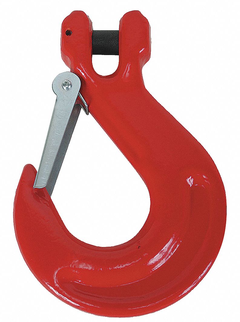

I have my break away cable hooked to one of my safety chains... it will pop just before the chain gets tight.....
Sounds like a good plan as long as you have some type of clip, not an S-hook, on the end that attaches to the vehicle. S-hooks can't be trusted, they might work when the time comes, or the jolt might just knock them off.
(I've been guilty of that more than once. I hook up the safety chain (with the S-hook), and sometime later I hear a jingling that is pretty much instantly recognizable as a chain hanging on the ground.

my hooks are forged slip hooks with spring loaded latches.... overkill but just the way I like it
