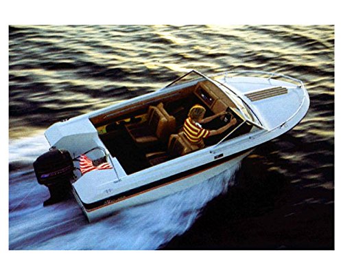

Why don't you put a few pics in your post? The imgur site is slow and we have no idea what we're looking at except dozens of pics of parts of the boat. You need some showing the complete boat.
Woodonglass
Dec 29, 2009
25,932
This will help the members understand what you're wanting to convert... IF you do it right and build Seat structures which will aid in supporting the sides of the hull, I don't see why you couldn't do it. I't fiberglass, you can do just about anything your mind can dream up, and your skill set will allow.
I qon't have any images of the full boat and can't get any till spring. So those are the best I have, sorry. WOG posted a decent one that gives you an idea.

Is that the exact same make, model and year as yours Josh?
If so, how is the dash built into the sides of the hull?
What does the structure up under the closed bow look like?
What exactly do you want the newly remodeled bow to look like?
W time, effort and money, you can rebuild it any way you want.

That's what it looked like almost 40 years ago. What does she look like today?
Has she been well taken care of in those 40 years or suffered 40 years of neglect? It's too hard to tell on imgur. Are the deck, stringers and transom solid? You need a good foundation for this.
If you aren't prepared to dump a bunch of money in her, I'd say leave her alone and save up for a open bow boat. You won't be saving any money by converting this one. All you'll have is the satisfaction.
I guess you plan on starting in the Spring, so you have a few months to research. I want you to make an informed decision, not an emotional one.
Yes that is the exact year and model. The only image I have that is of the full boat is the one linked below. I would like it to fit with the new dash I am putting in and I would like to be able to fit 1-2 more people in the boat. The idea is that I would make under the seats storage as right now that space is just for a spare gas tank and anchor. Well some great leg room too. The whole front part is open underneath and a flat deck.
The structure up under there far as I can tell there is 2 supports going across the boat one at the dash that is likely to hold it in place and the other one looks to be just a board with fiberglass over to going across the bow on the underside. Other than that the front deck is solid enough I have had 2 people up there (about 280 lbs) with some gear and it had no flex. It has what looks like cosmetic boards and with the rails my original idea was to just make it a walk through windshield that you would climb up over the dash and sit up there while the boat is just floating.
I am not sure how the dash is connected and can't know till I start tearing it apart because other than seeing the one support board it is covered by plywood tabbed into place.My guess is that is goes into it at a 90 degree and is fiber glassed into it. But that is just a guess and and idea with no real support behind it other than looking at my 2 other boats.
http://imgur.com/MSxHt4h
It is pretty well cared for, core samples show nice dry and light coloured wood for the transom. Deck is solid all around. Does have some nicks in the gelcoat and some rubber marks from the trailer other than that and the bent railing on the front it is in pretty good shape. I do need to fix the power trim and a new prop but that is more just regular maintance you would expect.
I have no problem dumping money into it, I do want to do a project but have yet to find the right one and am thinking this might be it. Hoping to dig into it come spring and hopefully start the building process by August. I do plan to do some drawings up before starting to build and also figuring out how to support it to prevent possible structural issues in the future. I am guessing this boat will be with me for 10+ years should it not get wrecked.
