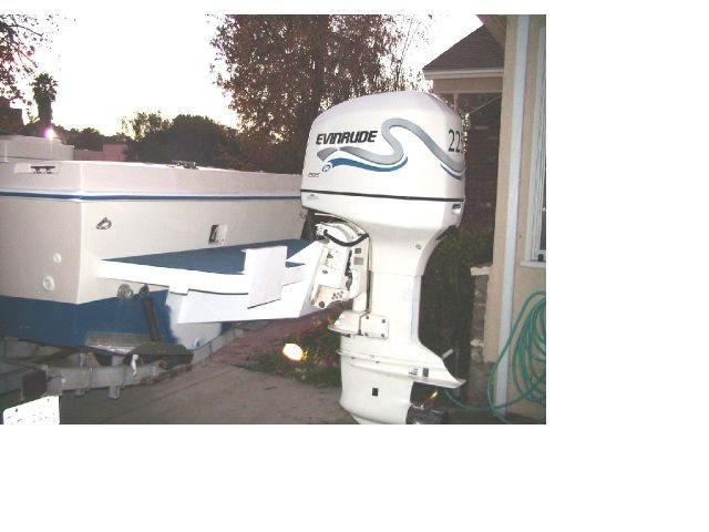

I call this a Conversion Pod
In the states the cost between $2,000 and $3,000 installed. A lot of the people I have heard about have stated that it definetly changed the handling of the boat in a significant way. Never had one, so I can't speak from experience. If you think this would be cheaper than replacing the I/O and want to risk the Handling issues then It's your choice. Just my 2?

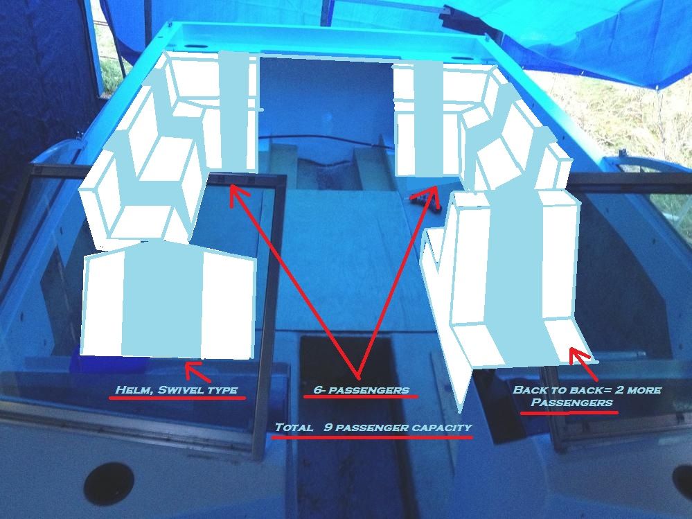

Planning interior layout along with engine drive service and installation. Not sure about seating.
The boat originally had 2 back to back seats and off course seats on each side of the engine cover. I guess we will mostly be 2-3 persons riding in the boat, but sometimes as much as 8 people when we go out with another family.
Right now I?m thinking one captains cheer and one back to back seat. what would you do with this space? (sorry for the poor picture quality)

Hi 24-seven,
This is my idea for your seating layout...
If there is the necessary room, it gives you plenty of seating for your max load, and provides for a rear viewing position to keep an eye out for the skiers/wakeboarders...:)
You can adjust and modify as you please to fit the space available...or change the First mates seat to another swivel type, for a safety seat...

WOW!
Never thought I would get this good suggestions, really appreciate it!
I like the layout, it also gives plenty of storage space for aditional fatsacs or wakeboards and waterskis. I will have to take some meassurements to se if its possible without giving up to much free deck space.
