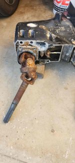

I will be changing the U-Joint on my OMC Cobra Outdrive. Water got into the OD and rusted the U-Joint and the bearing. (See Figure "Rusted UJoint")
I will either take the OD to a shop and have them replace the U-Joint and perhaps overhaul the OD OR Buy the U-Joint assy and install it myself. (See UJoint1)
Any thoughts on that? Have any of you done that yourself?
It appears that the first thing to do after removing the OD is to remove the Bearing Carrier #28.
(See Figure BearingCarrier)
I have removed the 4 Allen bolts #41 but the carrier has not come loose.
Any suggestions?
I also see that there are different thickness shims #30. That tells me that there are some detailed measurements to take to know what shim to use. That may be beyond my ability.
Any more thoughts?

Haven't done this on a cobra but have on a couple of alpha ones. With that much corrosion I would think you are also going to have to replace or put a speedi sleeve on the input yoke to drive as if the seal isnt leaking now it will shortly.
If you are paying someone it will likely be cheaper to buy a new assembly than pay labor to clean up the parts. If you are doing it your self take it apart clean up the pieces with a wire wheel or better yet sandblast, paint and then match up the u joints to a automotive application. not sure if cobras use the same u joints like gimbal bearings but the merc alphas match up to a Moog 315G for inside retaining rings and moog 344 for outside retaining rings. If you go online you can find the sizes and measure them up.

Given the level of corrosion, I agree with the fact that the input shaft seal is likely to leak. I would think about having a shop do it, and maybe replace that whole input shaft/u-joint assembly with a good used one or aftermarket, if the OEM is not available. What year is this? I thought it was a 1992? 5.8 liter Ford?

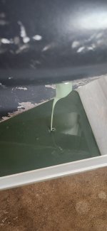

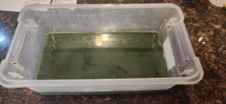

Here is a picture of the gear oil from the OD. It is a blueish-green color.

If you get brown crud out of the ujoints that’s not normal and they’ve internally rusted and must be replaced. If they fail with the boat up on plane it could tear up the transom mount & let water in the boat. Risky & potentially dangerous.

I think you do have water in the gear oil….
