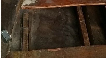

So I have everything I needed to remove out of the way. I'm going to cut plywood tomorrow and grind down old stuff. The only thing I don't like is where the outside stringer stops , there is nothing but the hull to support the plywood. I am probably thinking this through way too much but I can't stop thinking that maybe if I spray some foam in there before I piece the plywood back in there. Any thoughts ?

If you want, it would be eazy smeazy to glass a Cleat to the side of the hull to support the deck at that corner point to ease your mind.;)

It's tough to tell from the pic but the angle changes at the end of the outside stringer and the slope increases too. Not sure how I would glass a cleat in that would help for more than a few inches. I think if I put a couple bulkheads on the outside too , the strength should be there. Thanks for the feedback Woodonglass !

Well my wording might not have been to descriptive. This photoshopped pic probably show more clearly what I mean. It's more like glassing in an extension of the stringer to the hull!!!

It's an illusion from the pic. The outside stringer stops there because it has to. The pic doesn't show what it actually looks like. The hull starts to curve in so a cleat won't work. That's why I was thinking of foam just as something that might help with pounding seas. I love what you did with the photo though. It's great to see what ideas the guys on this site come up with. I couldn't do this repair without the guidance of this great site.

Could you just slide the extra stringer/cleat further down the slope of the hull . Keep it parallel with the original ...
Cut the bottom to conform with the hull ...

OK so I probably should have grabbed a bottle of Jameson and celebrated St. Patty's Day rather than heading down to the marina again. I started out pretty good, I was able to remove all the skins on the stringers. Holy crap Sphelps you were right about the respirators that stuff goes everywhere. Zool had said to plastic off everything , glad I did that too. So I'm moving along and I'm back by my shower sump pump where the stringers go into a bulkhead. Bulkhead seem solid but the stringer is wet, it probably goes for a foot or so. It is not easy to get to this because the aft cabin wall is above this. And that's connected to the deck above oh brother! Not sure what to do from here but I'm not feeling good about it.
As to the cleat towards the bow on the port side, I could sneak something in there to buy around 6 inches but I was really thinking about further up toward the bow but I think I have bigger problems now!

You dont want little bulkheads outside the outer stringers against the hull side, you will just create hard spots with little pointy wooden spears, poking at the hull ;) Just put it back as it was, cantilevered over the outer, about 1/2" from the hull side, then bed and tab.
If the stringer is wet and starting to rot by the bulkhead, you should probably change it, its already exposed, or you can cut out the back section, and scab in a new section, then glass it all...
