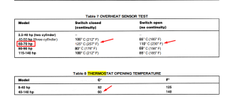

I know it is strange, but that is chart (in picture), for my Tohatsu 2-stroke. So, you say, that my outbard is overheating (closing the sensor = trigger alarm).

That table is very strange, but just for your motor. The rest of the entries looked about what you would expect.
Even if the coolant water was pressurized to 7lbs, like an automobile, the coolant water would still boil, before the sensor closed.
I am hoping the table is wrong.

The Table is from owners manual, and I checked on other languages, it is same. Also checked in the Service manual for all 2-strokes 3 cylinder (60-70hp) and the temps are unreal.
