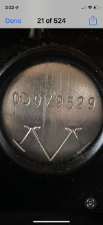

Start by posting a serial # , year or picture of this motor
coppengerm
Jan 15, 2022
11
I have a 5hp 2 stroke mercury. I changed impeller, and prop seal. After putting back together I can’t get lower unit to shift right. When I push shift rod all the way in lower unit it’s in neutral, not reverse. Then pull up to neutral position it’s in gear and when I pull all way out. I can’t for the life of me figure out what I’ve done wrong, or what’s changed. It was working before I disassembled it. Can someone please help. I can’t find a local shop that works on small mercurys any longer. Thanks!!

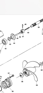

The parts diagram shows a part ( clutch spring retainer item #27 ) not sure where is goes.----You might look for it in your motor in your parts cleaner or on your shop floor.

Am I missing this part? Part number 46 that looks like goes in before pushrod/cam follower?

I’ve looked everywhere. I can’t find it or find a parts list for it to purchase one.
Honorary Supreme Mariner
40,003
I see that item marked as #26 or #27 on my diagram.------It may in fact be trapped in the assembly on the end of the spring and it can not fall out.----Be easy for me to check this out.
