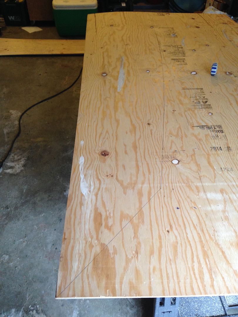

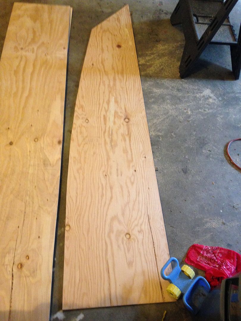

Ok guys! The project is officially underway! I bought all the plywood needed and I cut out the side panels.
First Cut of the project!

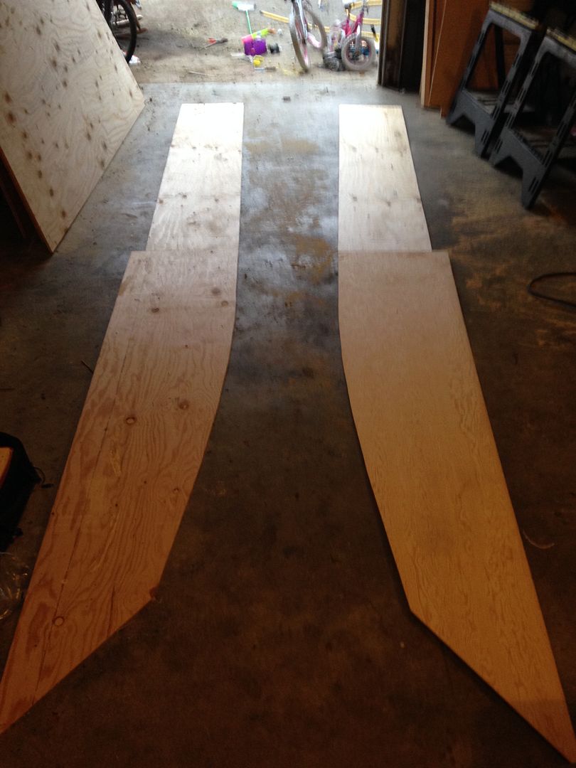

The angled side panel laid out.
The angled side panel cut
The rest of them
A couple things the plans do not clarify are what thickness plywood to use for what? I figued the sides had to be 1/4" to be able to bend into shape. The rest I am not sure. I am going to have to do some studying online .

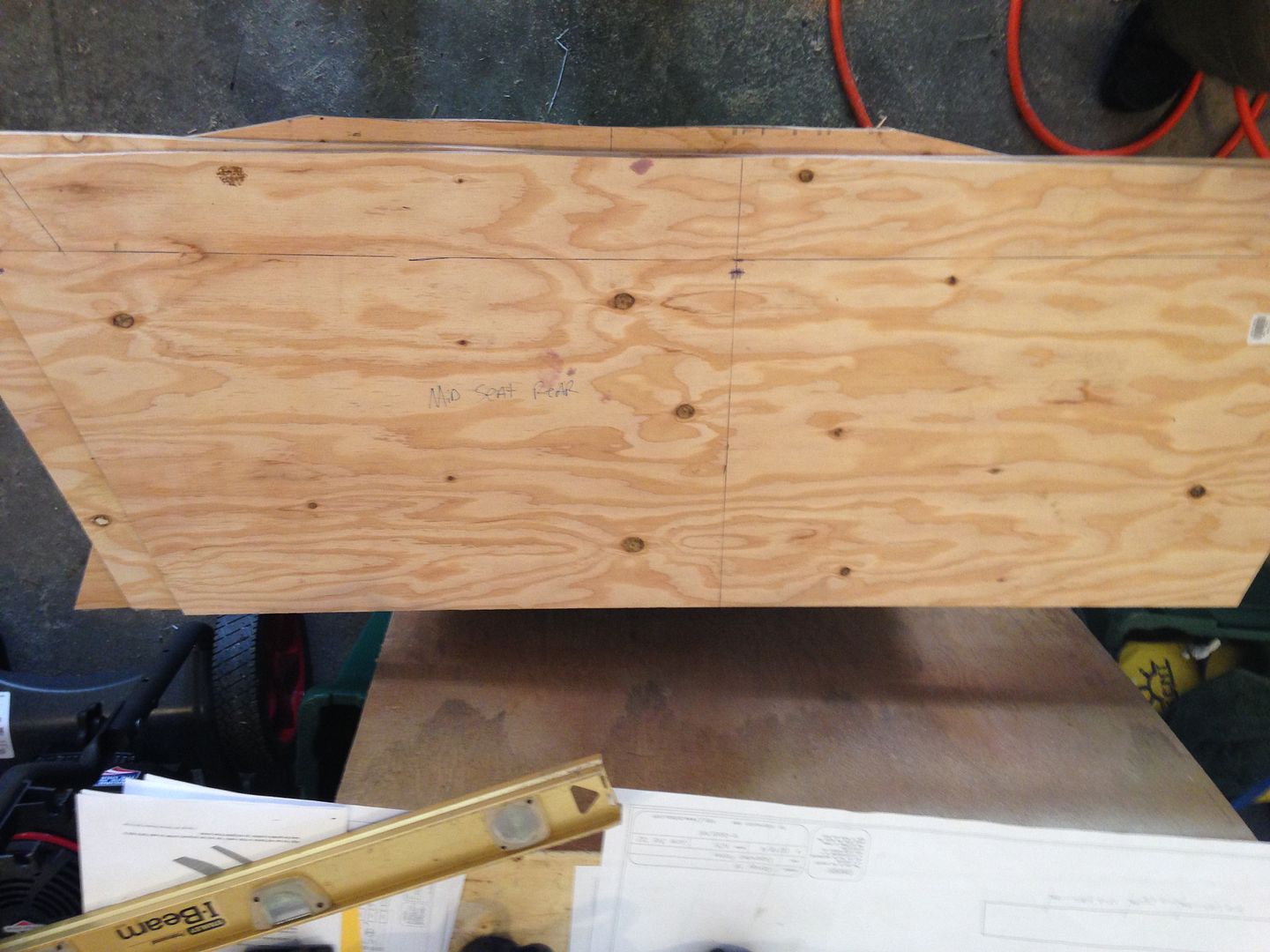

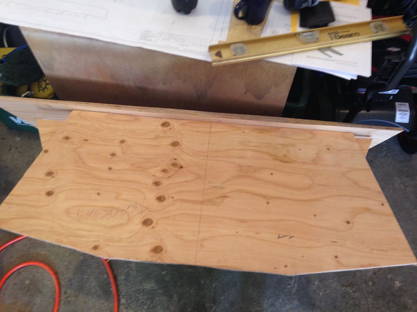

Here are the side laid out. All the wood is cut exactly as the plans say, But I am confused why the back part of the boat has shorter sides than the front?
saginawbayboater
Mar 8, 2012
677
That is weird. i'd read the plans front to back, and back to front,and back again a few times. maybe something will pop out about it!

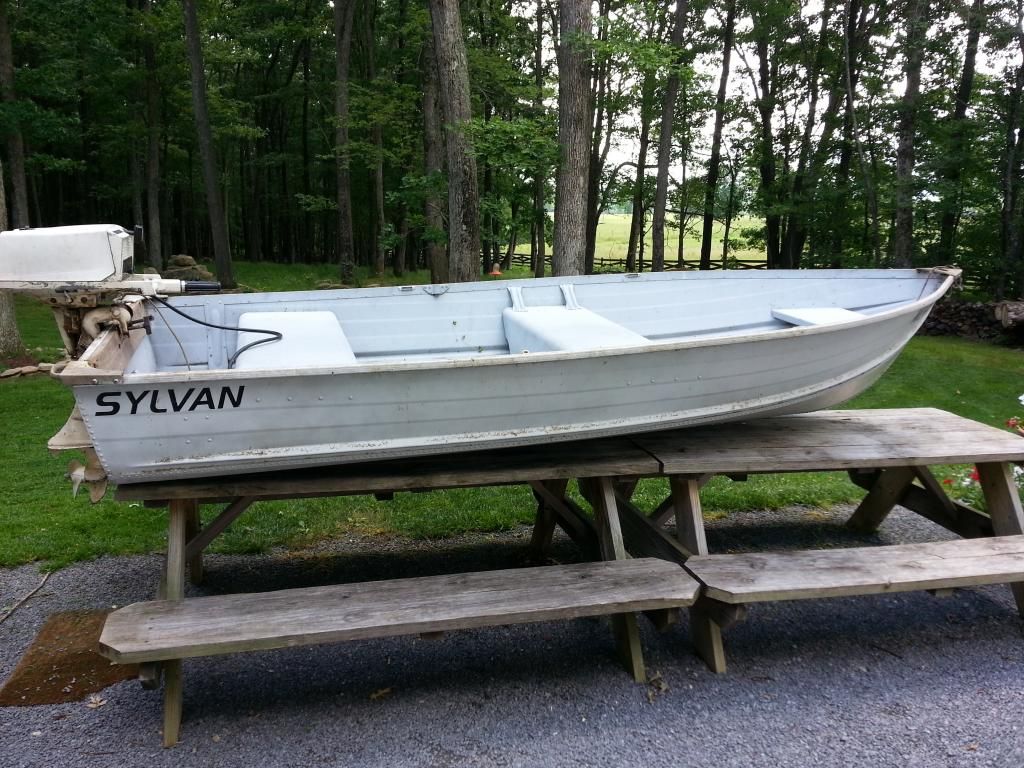

the stern of many boats is 'shorter' then the bow, look at my 'new' to me Sylvan Sea Breeze:
For the purposes of your skiff, it's taller because of bow rise:
Unless I'm missing something, I don't understand why the stern end of your side panels has a step down at the top edge:
Isaacm1986
May 20, 2009
1,086
Well I figured out the cut. I was miss reading the plans, So i recut those sides and now they fit. We have all the pieces cut out and labeled, not to begin assembly.

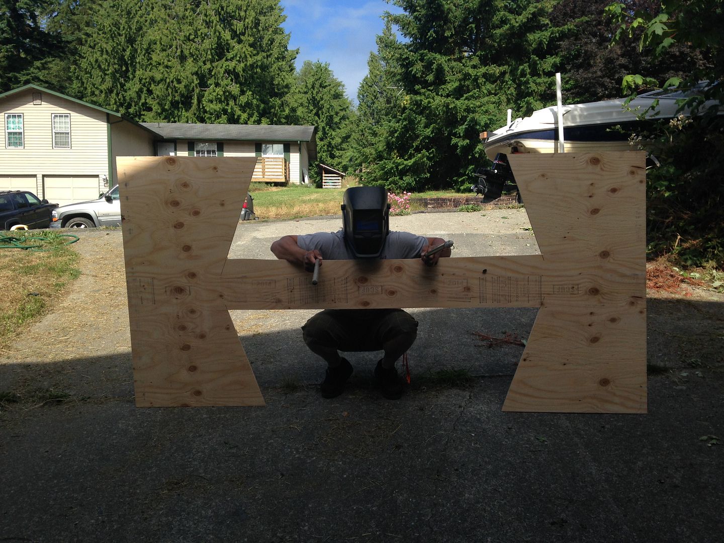

My buddy decided we should build tyfighters instead...

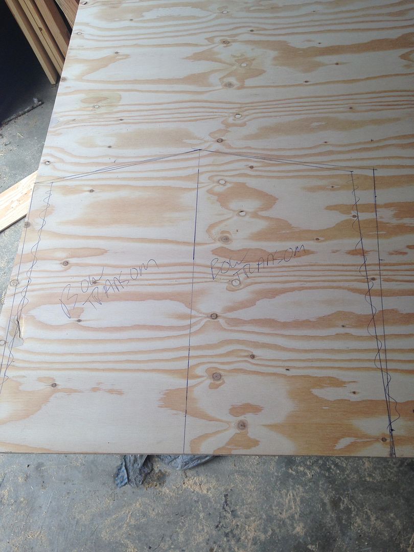

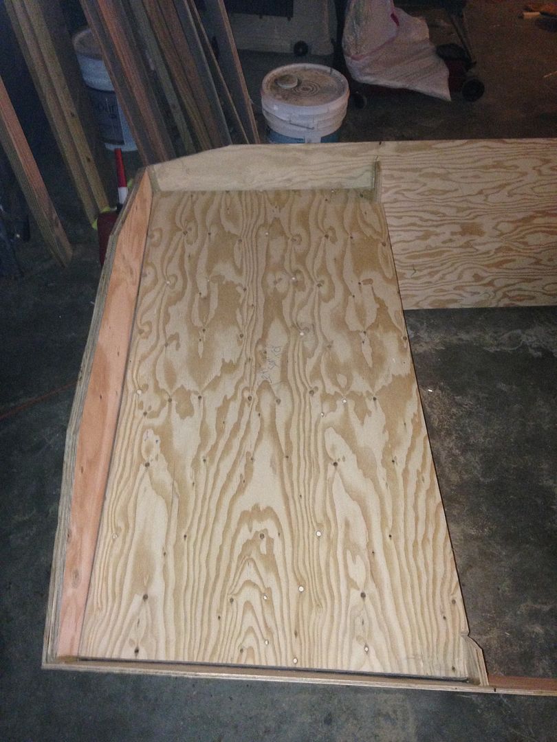

Transom
Seat frames

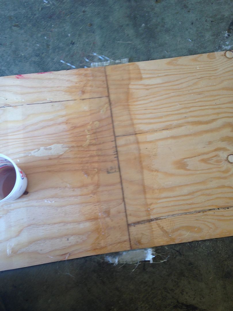

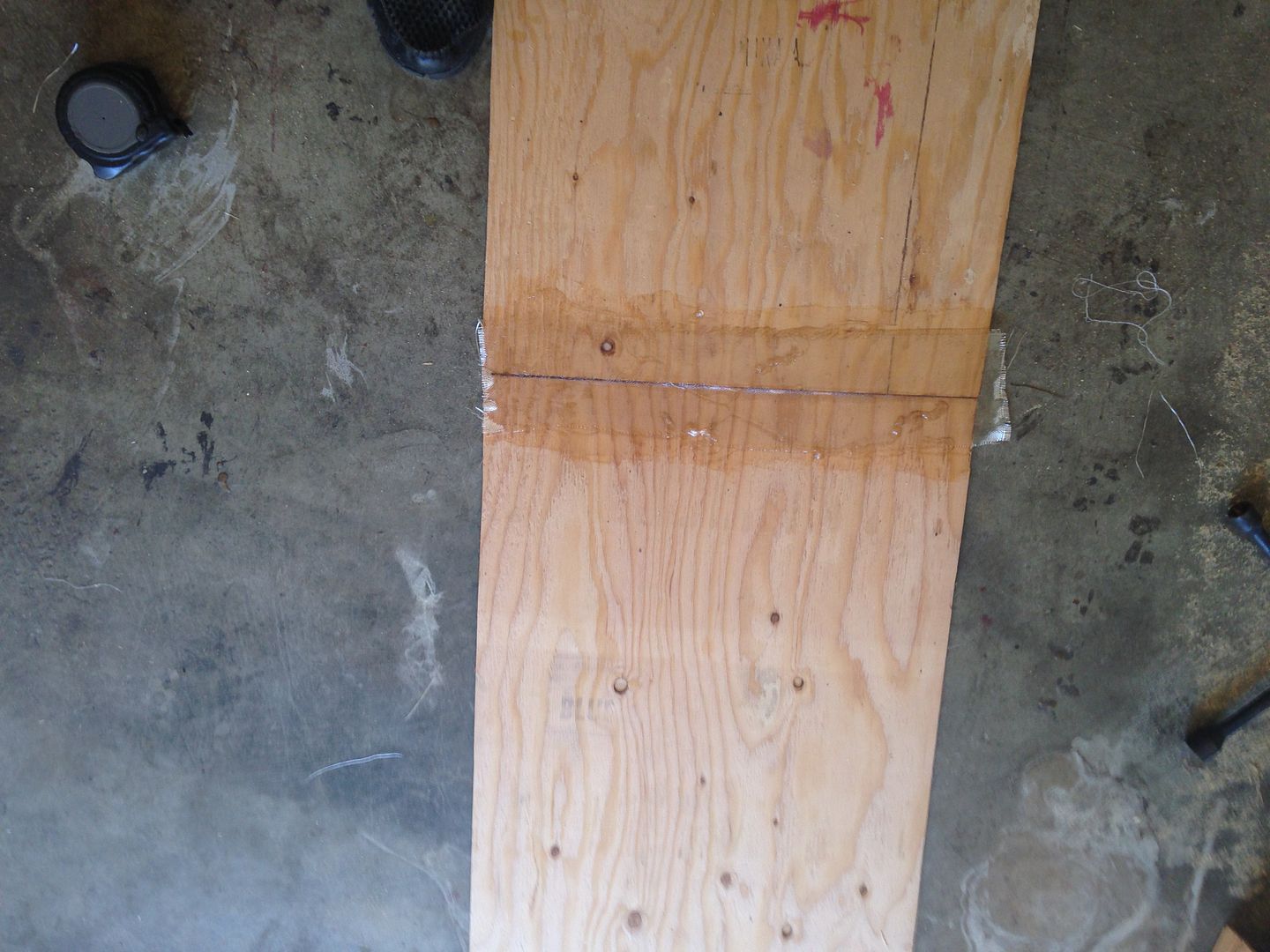

FG splice for the sides.
Now we are waiting for the fiberglass to dry. Then we can begin to put it together.

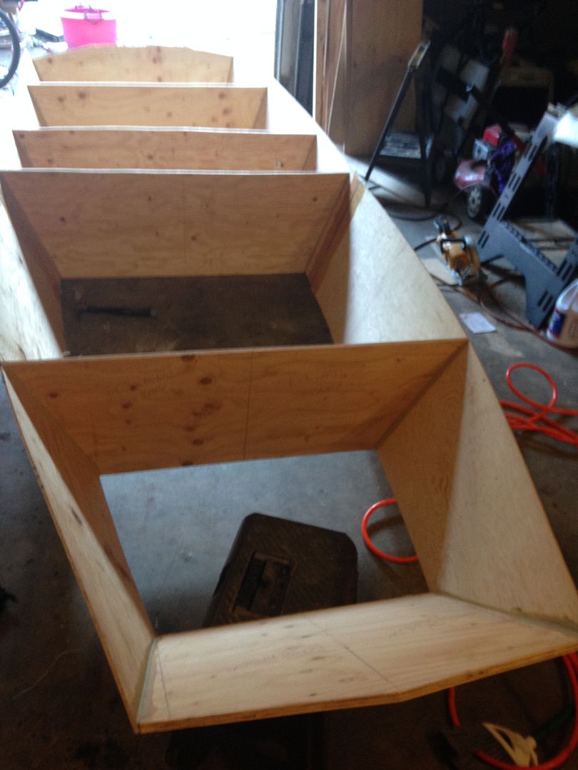

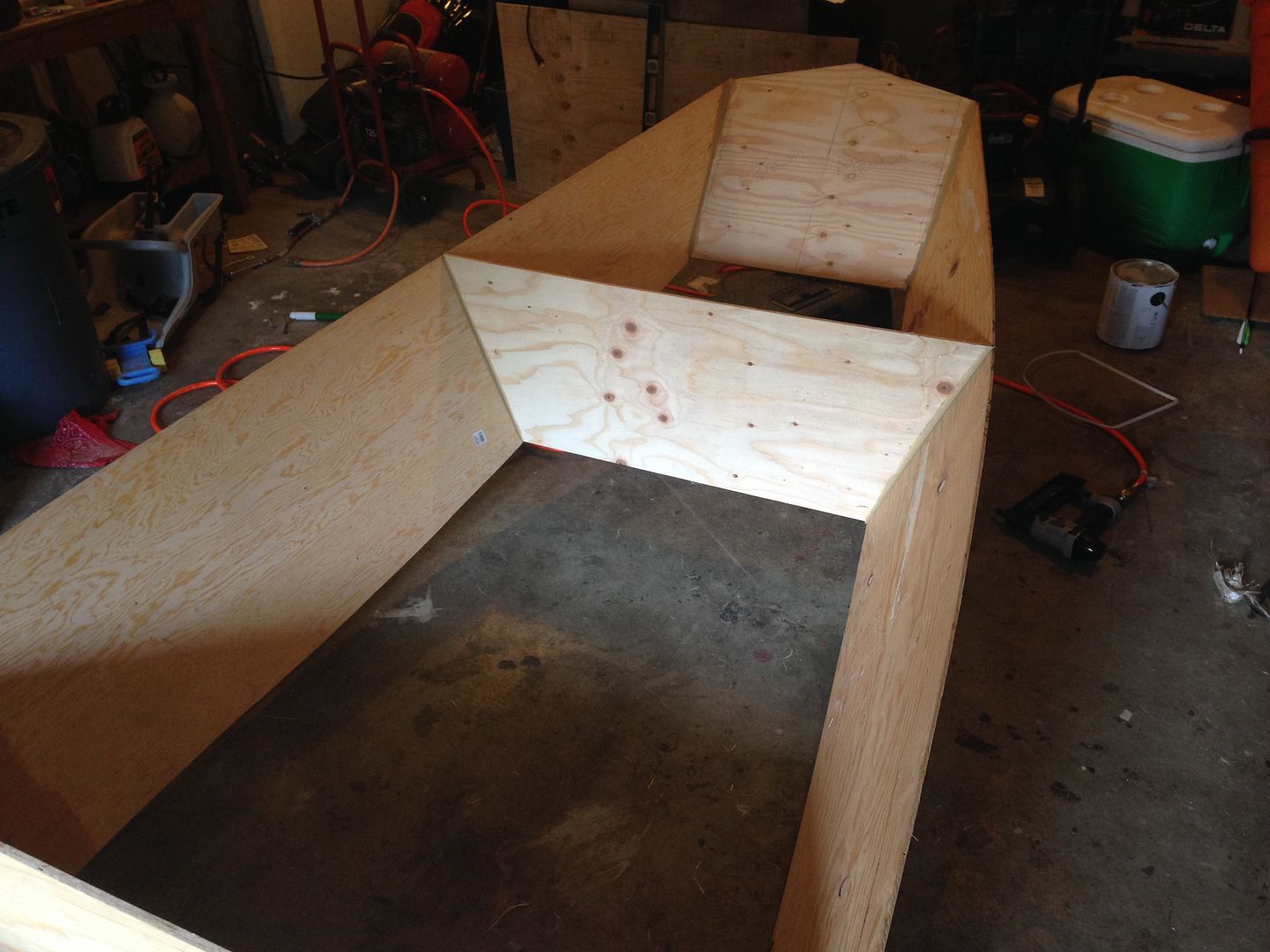

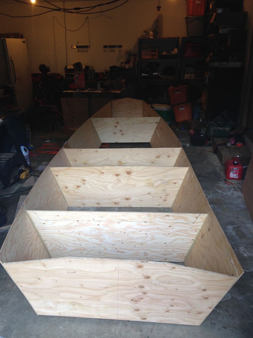

Got it all framed up. Done for the night. Will continue on it over the week.

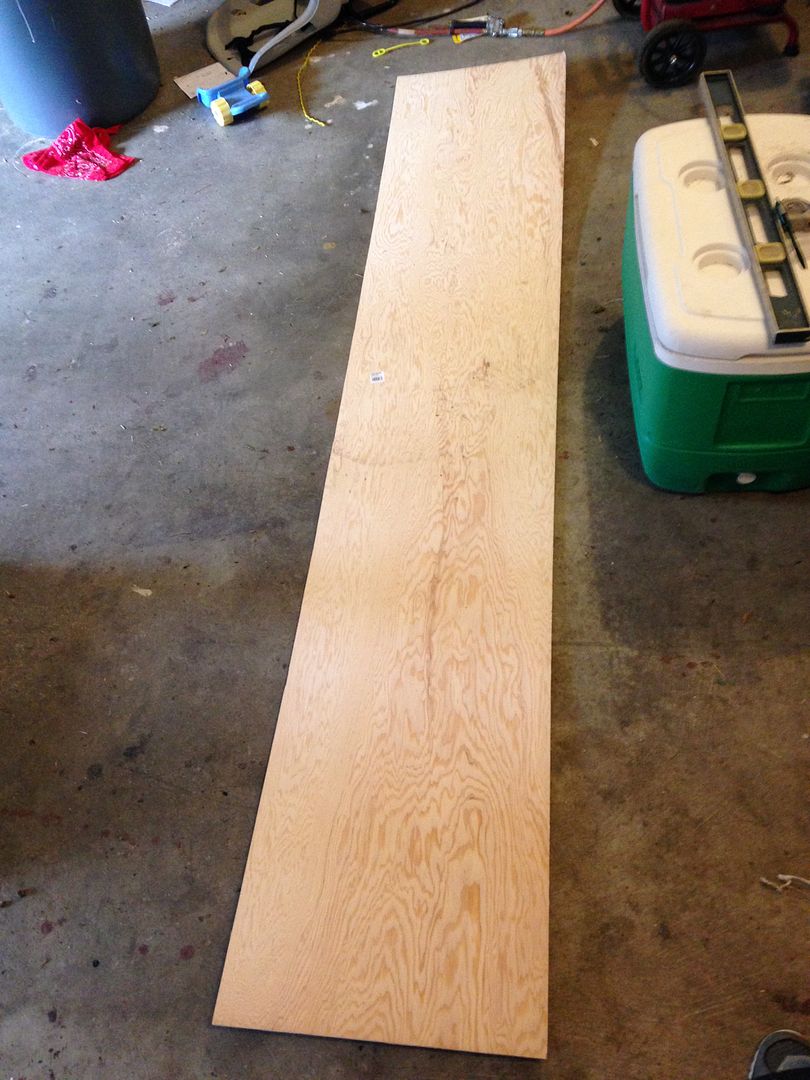

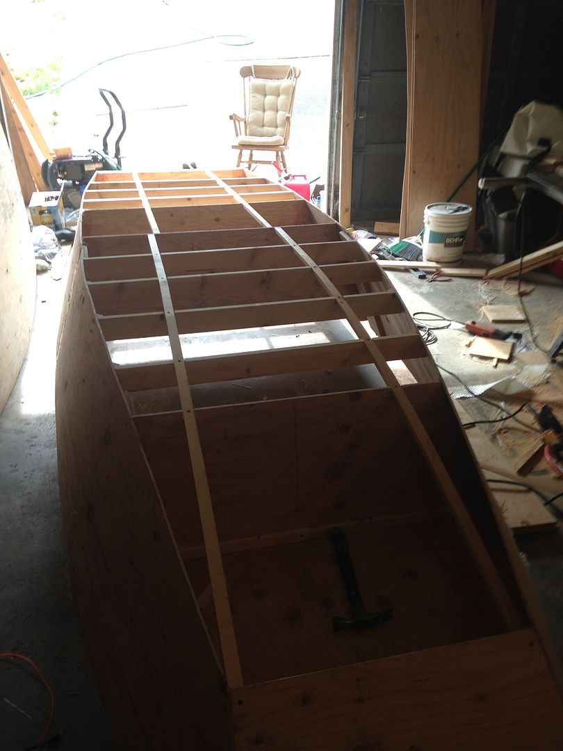

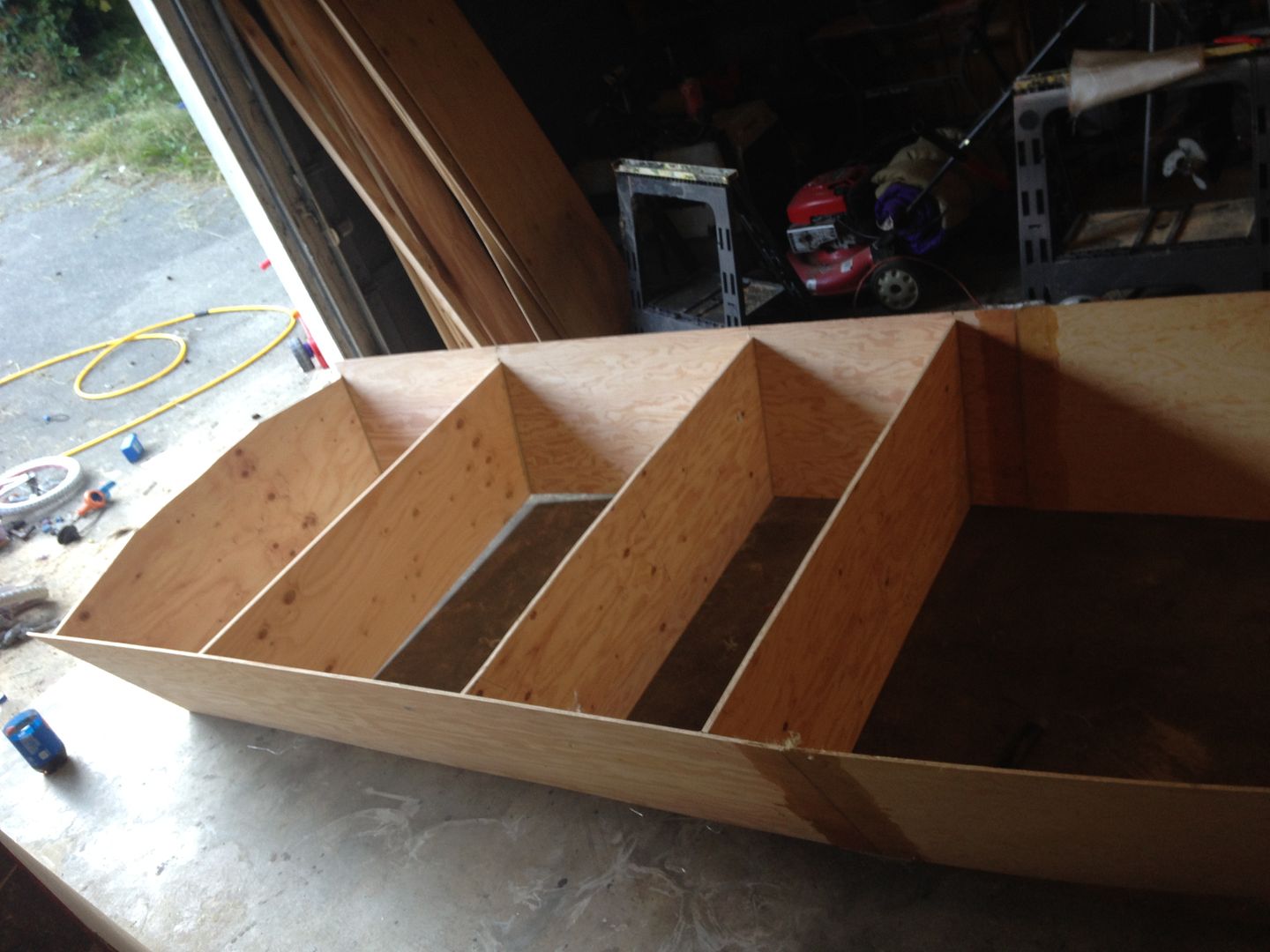

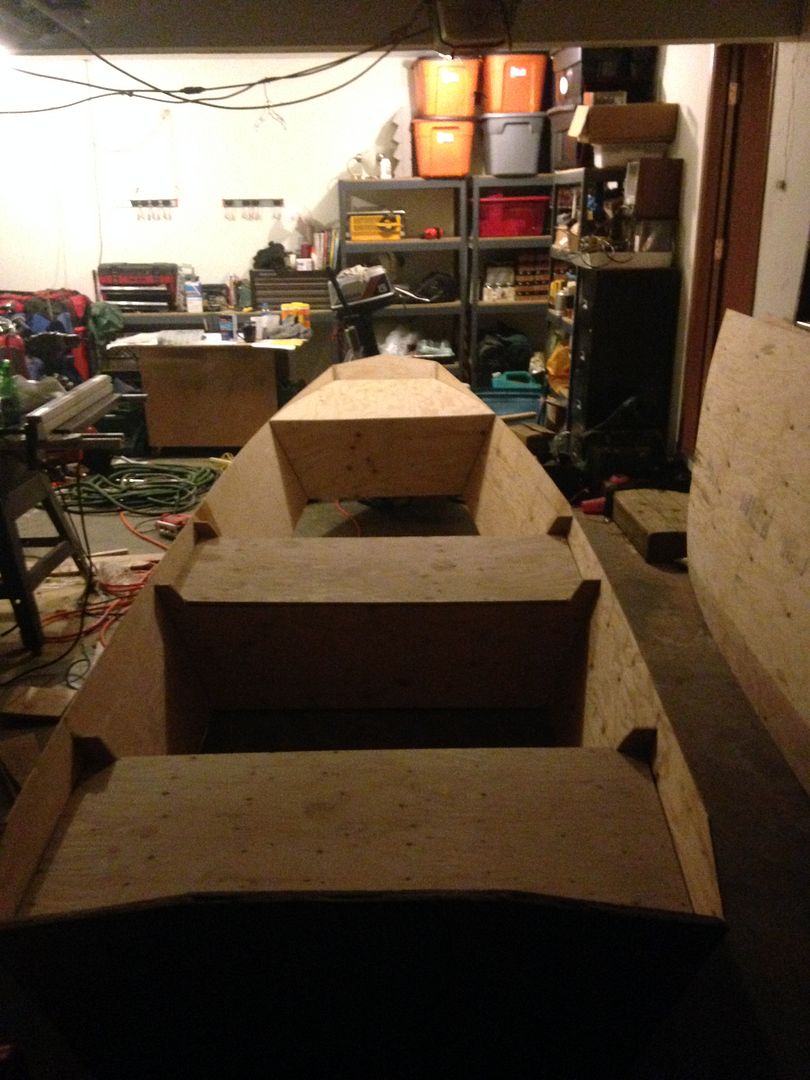

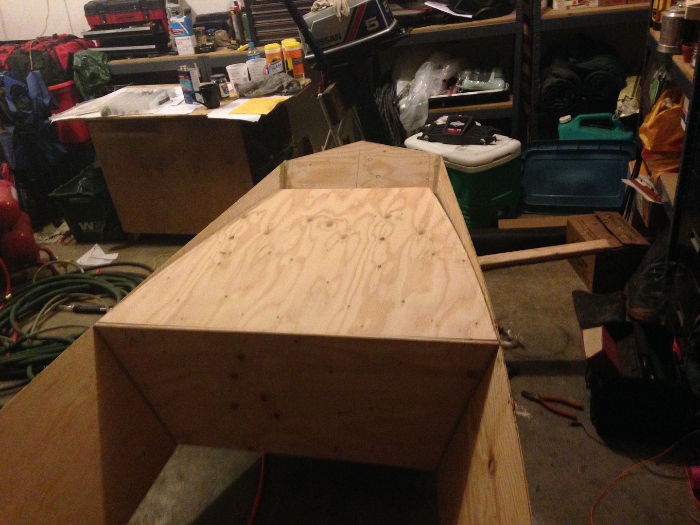

Weekend Update. Yesterday we got the seat tops installed and all the seams fiber glassed. Today we went off plan a little and made stringers for the boat and got it flipped over. It is ready for the bottom to be cut and installed. I decided to add the stringers and "overbuild" the bottom. The plans even warn not to put too much weight up front. This will be my duck hunting boat, so It needs to be able to carry my dog, decos, and gear. So we added the stringers to give the floor strength.
Seat Tops:
Stringers and bottom

Once everything is together than we will begin the fiberglass part.

Really starting to look like a boat now ! I guess the rocking chair is for contemplating your next step .. Everyone needs one of those .. :lol:
