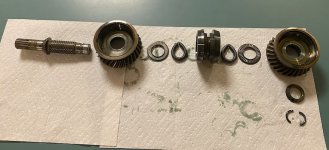

Here is a look at the cone clutch & upper gear set from my Bravo 3 when I took it apart for maintenance a month or so ago . . .
All the bits & pieces . . .
