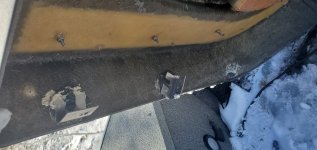

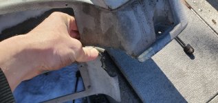

Had a cold spell of weather, but now had a chance to work on the boat again. The consoles turned out to be a bigger disaster than I first thought. There was basically only one screw holding the entire console on the boat. I got lucky it did not fly off when I first brought the boat home. No wonder the windshield did not line up. These stupid aluminum brackets got glued to the console with some crap at the factory. some have now completely came off. Lasted about 12 yrs.
I'm thinking of grinding the glass a little, and then fiberglassing these brackets on. A screw should prevent the brackets from coming out of the pockets formed by the glass. Thoughts? I guess it is time to now get the grinder out and make some dust. (The irony, I thought I was buying an aluminum boat 🤪).
These loose brackets also explain why the corner was looking so messed up. I was wondering how they could have done such a hack job at the factory... Turns out it was not the factory, but the console turning into a rattle trap...

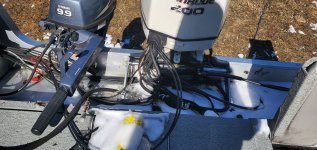

Finally, lets appreciate what may be the worst rigging job I have ever seen... I got a rigging hose to get that all sorted. Seems like I am looking to do a complete re-rig.20220329_150444.jpg

Finally I got something done and got the engine all re rigged and the wiring fixed. Some dummy connected both charger banks to one battery despite the fact that there are two batteries beside each other... But I got that fixed.
