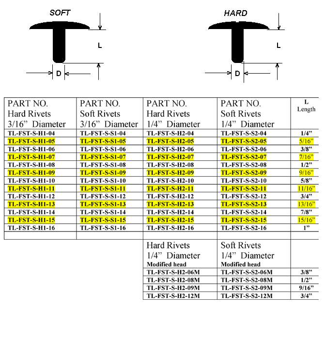

Bucking the existing rivets would be my first choice rather than replacing them with pop rivets. Done properly, you've fixed the leaks without changing from the original. You may need to enlist a friend's help. If you have a lot, an air tool would help. A few can be done manually as Scott says. It's particularly simple when both ends of the rivet are flat as you say. - Grandad

If you have access to both sides of the leaking rivet, you can use solid rivets & buck/drive them. Or use closed end blind rivets, 3/16" shank rivets can be tough to do w/ a hand riveter, but it's possible. But for $40-65 you can buy a harbor freight air riveter that many really like..

B. Measure the hole diameter, 3/16" is the most common diameter. The length/reach is called the grip range with closed end blind rivets. You determine the grip range by adding the thickness of the 2 materials together, typically this will be .063 + .063 = .126" or 1/16"+1/16"=1/8". There is some "play" in the grip range so you don't have to be exact, just close. The .126-.250 grip range should work for you, but you may want to pick up a box of .020-.125 if your materials are thinner. It never hurts to have a selection of rivets on hand when you own an aluminum boat.

So closed end, blind rivets. What material? I saw numerous options on JayCee's site. Aluminum with steel mandrel or what is recommended for something like this? Especially when going with 1/4" if those were needed. I will be trying to drill/grind one of when the weather breaks and will see what the hole size is>
