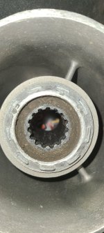

I attached the pictures for the prop I was talking about. The drive is an alpha one.

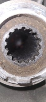

Something don't look right. The nut is too small for the locking ring. You may need to remove the prop and be sure all the parts for the hub are there..

^^ Yeah, some pics of the prop and parts when off. Including the shaft.

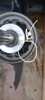

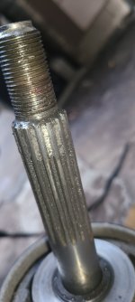

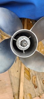

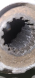

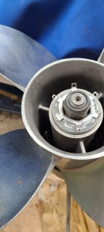

Ok finally got prop off and I think I found out the problem. With it not moving boat anyway. If you look at the pictures you can see where it looks like the splines on the lower grinded off the splines on the propeller. Also on thr picture of the lower. What is the the white tube that I pointed out? It looks like it is cracked down the middle or something.

Looks like you may have the wrong prop and certainly some mis-matched parts. I know only what mine looks like and that ain't it. The shaft is probably ok with a bit of work..

Believe your drive is a GENII version. It may make a difference when sorting out the prop, shaft & hardware issues.

I'm guessin' that piece of tubin' is the alignment tube for the raw water pump,.....
