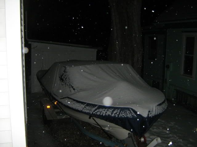

yep, it sucks being poor and having to store yer boat outside. but that's the way it is for lots of us i think. obviously, me included. while there's many ways to tarp a boat. i think the key is keep the water running down hill everywhere. and keep it taught so it don't get loose or flap in the wind. you'll need to come up with the best way to accomplish this for your boat..
i have a aftermarket semi custom cover i think. it sort of fits. mines a closed bow. i have a beach ball on the bow a small kickball on my roof and a pole with a flat plate behind the top. then i bungee cord the cover to my trailer. it's mostly taught.... no wind flapping, no water trapping as it runs off.. i travel coverless..
preping for winter i guess
in the winter, minus my small ball on the top which was an after thought....
yes, i have to brush the snow off as the angle isn't great enough for it to fall off... that keeps me in touch with my boat over the winter.. ;)
