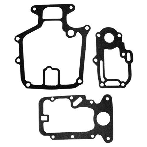

My motor is a 507y8c. Would this set work?
That is the part# listed, even though the description says it for 3 cyl Forces.....only need the larger one on the left in the pic.....this kit probably covers many models so I guess you get the other 2 gaskets whether you want them or not.
Okay so the middle one doesn't go between the spacer plate and the powerhead? I could buy just the big one. The serial number seems to match mine.
Yeah....after looking at the diagrams again, that middle one looks like it goes between spacer and PH.....that one on the right not sure about.....all the listings I found for the exhaust gasket come with all 3.

Okay cool I'll get all three then.
I just noticed that Nordin said not to remove the spacer plate in post#4....not sure how you can replace that exhaust gasket without taking it off? Maybe he will chime in later and explain.....I would just get all three to be sure.....
