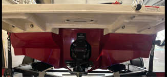

I've done some reading already on here about other's experience with trim tabs in general, but am looking for some further feedback on trim tab selection more specific to my application. Here are some pics of my transom, to give you an idea of what I'm working with, which is a 2105 Bayliner 175 runabout (which is about 2k lbs.). The transom has an overhang, which based on my initial measurements indicates the trim tab actuator/piston would be mounted pretty much vertical (I've seen some pics of installs that are vertical, but not sure if they were SLT's). The boat performance I'm looking to improve is bow rise out of the hole, and reduced porpoising while on plane in chop. I'm looking for opinions as to whether the Bennett self-leveling trim tabs (the SLT-10's) will likely work well or not given my application. I contacted Bennett and haven't really been getting a clear answer. They indicated that vertical mounting on the SLT actuators results in too much downforce on the trim tabs which produces poor performance. I asked about actuators that have less spring force (which I've read about on a few other posts), and it seemed like he was avoiding my question, or just simply didn't know/understand what I was talking about. They did recommend that I mount the trim tabs more inboard (pic with blue lines) which would allow for the actuator to be slightly less vertical, although not all that much by my rough measurements, at the expense of side to side stability. I realize the controlled systems will be superior to the self-leveling system, but I would like to avoid the added cost if the self-leveling system will still have ~60% of the performance improvement of the full control system. Price wise, we're looking at $150 for SLT-10's vs $500 for M80's (which is the hydraulicly controlled sport tab for sized for my application). If I hear that the SLT-10's simply will not work in this application, then I'll have to bite the bullet on the M80's I suppose, but open to hearing suggestions on other models/brands in a similar price range.

My boat has a similar transom (see picture below; not my boat, but the same model) and I was able to install Nauticus SmartTabs on it. I contacted Nauticus customer support and they said the tab's pistons could be mounted to the bump-out portion of the transom, but we might have to adjust the pistons to a lower pressure setting due to the placement.
I installed the tabs as shown in the picture and they work great. My boating is all lake/river boating, and the tabs were installed to eliminate chinewalking and bowrise on takeoff, which the tabs do remarkably well. I'd install yours as far outboard as you can.

I got the Bolt trim tabs installed this weekend. It all went pretty smooth overall. The most time-consuming part was cleaning up all the excess 5200 that squeezed out upon tightening the fasteners. I used a generous amount of 5200 to help deter leaks in the 24 holes that were drilled. On the upper hinge mounts I went with stainless through bolts instead of the supplied screws, as the transom was not very thick on the bump-out section, along with stacked washers, and lock washers. The port side was pretty tough to reach behind the gas tank, but I was just barely able to do it. A helper would have been great to hold the bolts in place while putting on the nuts. Instead my "helper" was a piece of duct tape holding the allen key on the bolt on the transom side while I turned on each nut. The reach was tough enough that I had to do it all by feel, but I got it done with a little patience. The starboard side was much easier as there wasn't much interference. The wiring and the helm control were pretty straightforward and went quickly. IMG_8074.jpeg
