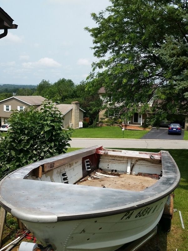

this is a late 60s Jet Star 15. I would love to learn the actual year if anyone can help me. (fyi it has a single knee brace in the center of the transom if that helps. Rated 50HP max.
here it is at the start. Once i emptied all of the water out of it. (at least i know it is watertight!)

I got it home and started ripping!
Transom is actually fine, so I won;t need to replace that.
