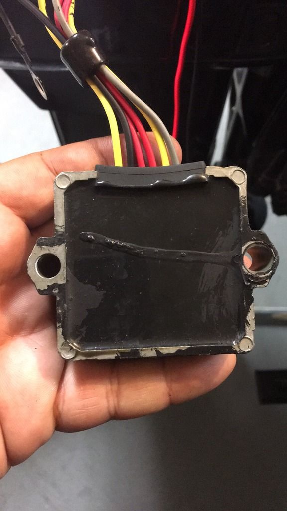

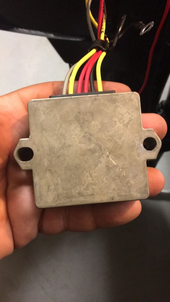

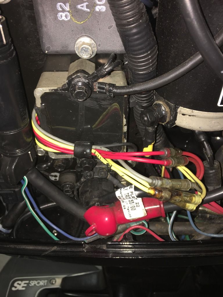

The next day got the cowling off and started looking and noticed somethings, well something.
Anything look a bit off?

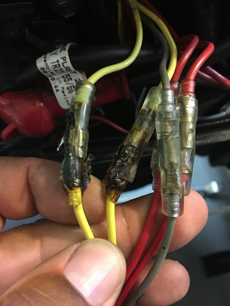

Well the regulator itself looked ok, its the wires from the stator that looked bad!
New one is on order, we were able to get them connectors apart pretty easy, we didn't do any testing with the motor running because well we didn't want it to catch fire. We also didn't have a voltmeter on the boat before this.....

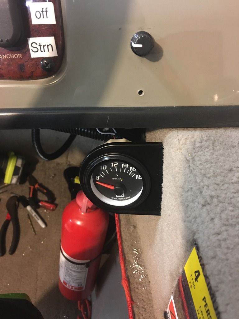

So I was told the following. I need to replace the regulator, new on is on the way, added the voltmeter, and was told to run it and see what the voltage is coming off of the stator. So now I have some questions....
When installing the new regulator I am assuming that yellow to yellow, red to the appropriate red, and all that. But it doesn't matter which yellow goes to which as long as the yellows are connected to the yellow?
How do I test the voltage coming off of the stator? Can I run the motor with out the voltage regulator connected?
What should the voltage be while running if its properly charging I am assuming less then 15v but more around 14v? I was told to check this on the water while running at about half throttle.
To wire the voltmeter up there was an open/empty switch that we hooked into (now just to remember to flip that switch) because I was a little uncomfortable cutting the wires near the ignition because well there was a lot more there then expected and they are like epoxied on the ignition. The switch works just fine hooked it up read fine, then hooked a battery charger up and the gauge went up when the charger kicked on.

It makes no difference on the two yellows from the stator, just connect yellow to yellow.
The max voltage should be about 14 volts.
