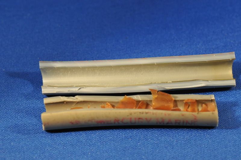

Here's what my grey stuff looked like after just one year(!?) I do run my boat virtually every Sunday but c'mon, a year? Only reason I caught it cuz I was installing a new clear inline filter. Whew! That was a close one.
Went with the new blue fuel line from Sierra. Buddys shop I got it from has had a chunk soaking in a Mason jar of pure ethanol for 9 months. No signs of deterioration.
With the amount of havoc that grey crap is wreaking there really oughta be a recall. I wouldn't be surprized to see a class action lawsuit?
Do yourself a favor and get rid of that grey garbage NOW!
