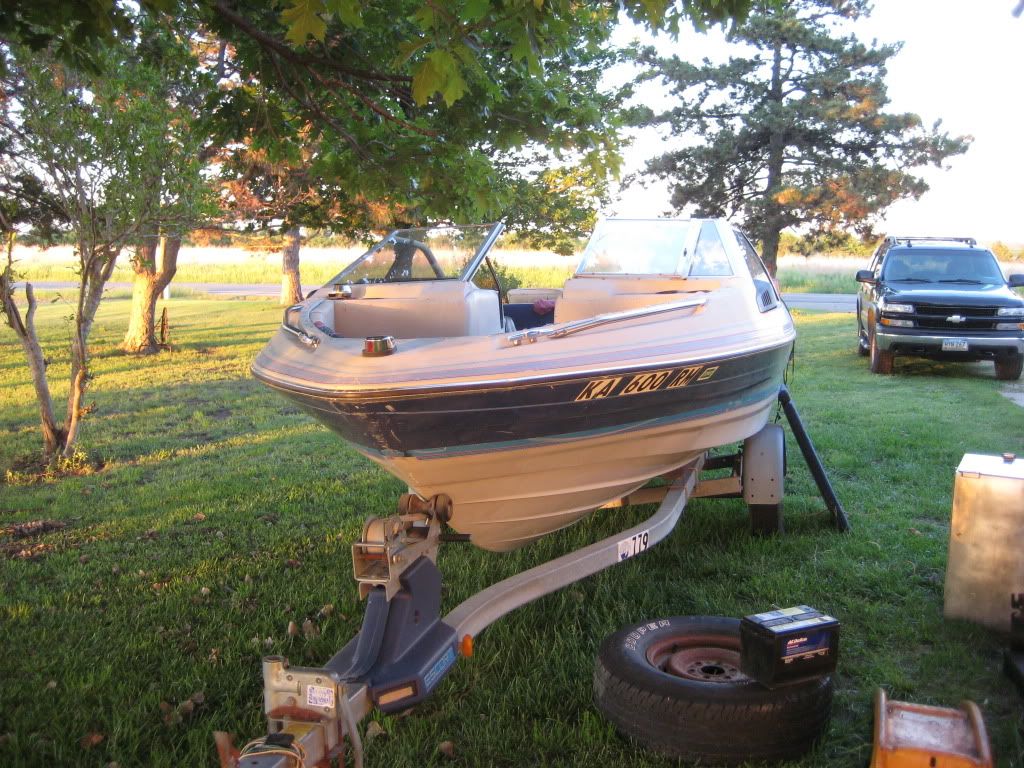

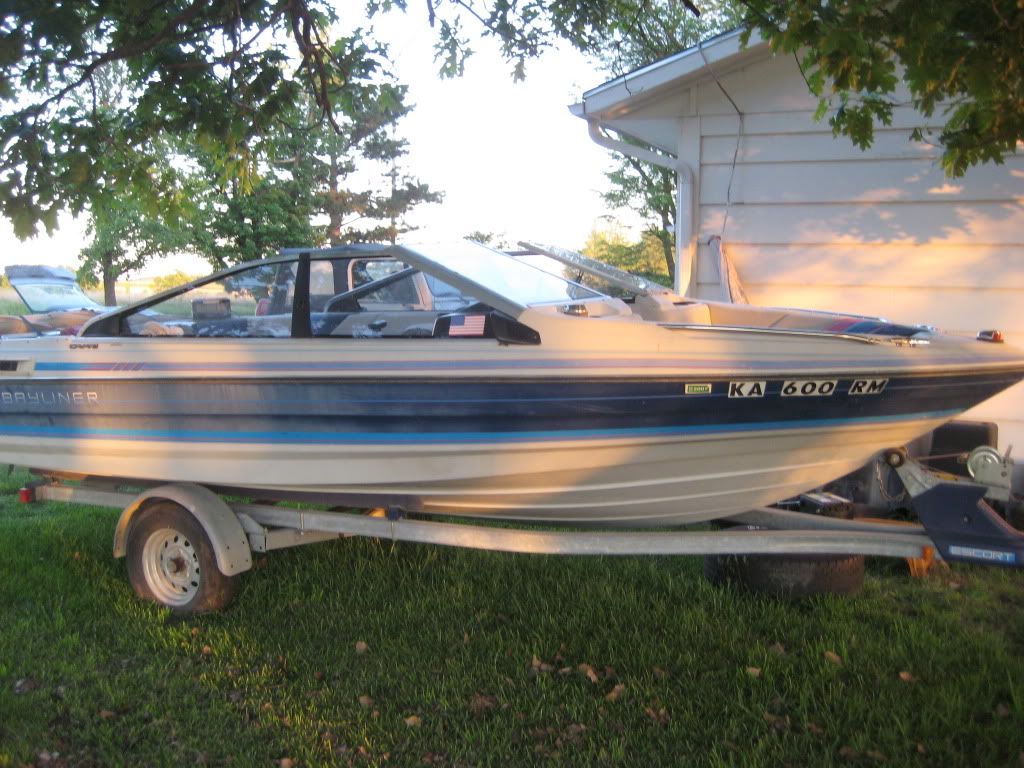

Hi guys,
Well I finally got the pictures taken so I need your honest evaluations and expertise.

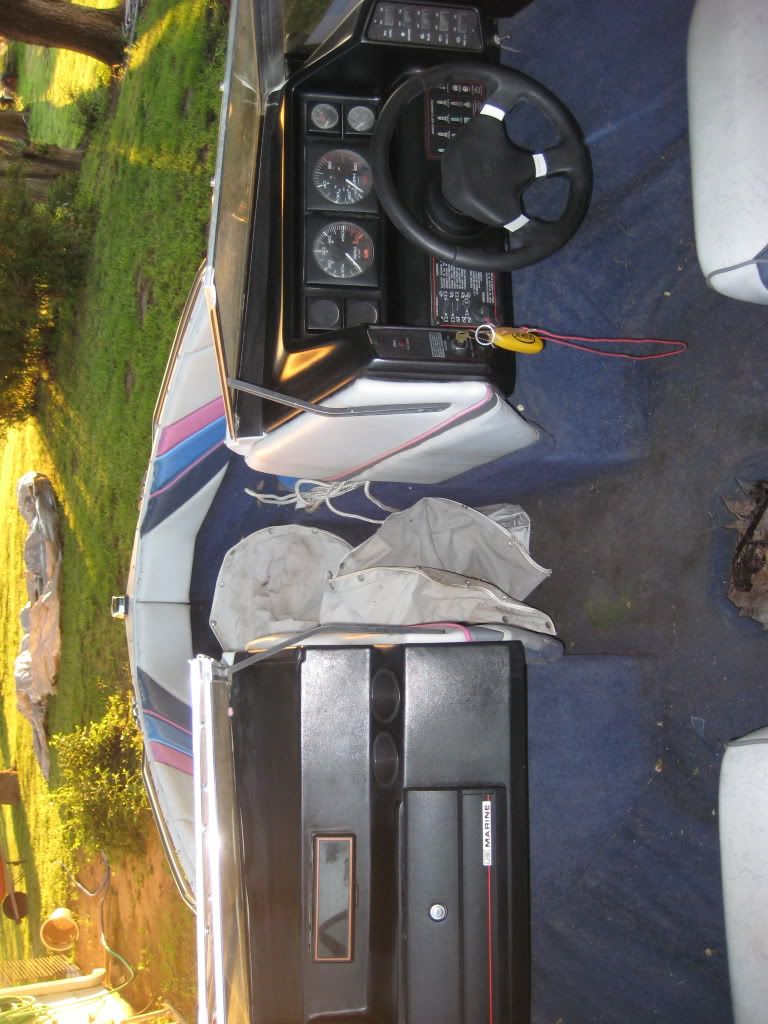

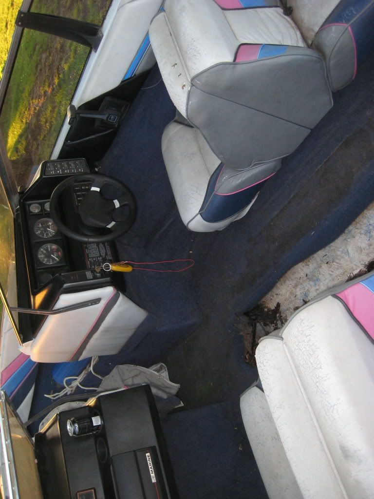

The flooring around the seats and the walkway to the bow are soft. But the seat bases and the upper wood all seems solid. I know I will probably have to replace the stringers too.
I took someones advice here and drilled a couple of small holes into the transom.....and went through the hull (duh) but their just 5/16th each. The transom seems pretty solid but the drill shaving did seem wet and the most resistance was when I breached the hull.
I haven't bought the boat yet but I can get it for only $200. I'am still having problems with no spark to the plugs but I have another thread in the electrical section on that.
Has anyone ever just put a metal box around the existing transom instead of ripping it all out? I'm awful with woodworking and I haven't ever touched fiberglass work seems like a box over the existing transom with some supports might do the trick??:confused:
Tell me what you think for the price
Thanks!!!!

What motor does it have?
We are not fans of "band-aiding" transoms here. I don't mean to come off like a jerk, I really don't, but if you're planning on going into this halfway, then I'd recommending not buying that boat. Believe me, a rotted Bayliner (that probably has a Force motor on it that is difficult to get parts/service for) is not the best way to get on the water cheaply. I'd recommend you look for an aluminum outboard powered hull.
(on a more positive note: there's way more than $200 worth of stuff there. That's a real nice looking trailer.)
You're not being a jerk. I was thinking the same thing as I typed the question. I usually don't do anything halfway, but I don't know squat about boats.
I thought if I didn't fix the boat and just parted it out that I could probably quadruple my $200.
I just get an uneasy feeling working with wood and fiberglass. It's something I've never done before.
I'm still on the fence about purchasing the boat. I have a friend that knows a guy who is a boat builder and repairman. I'm going to try to get it over there for his opinion.
Thanks for the response.

200 $, doesn't seem bad, but it will take at least 1,500 $ to fix her.
The wood work and the glassing isn't really that bad.
