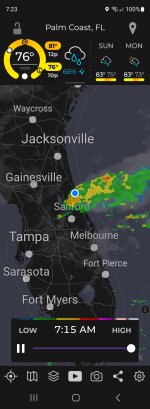

Seems like mos. of rain here, always wet, wet, wet. Should start to clear by next week and a little warmer. Even the boat tarp is turning green. I'll have to do that before it gets too cold.
