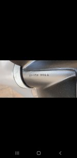

These are the numbers on the props but I'm not sure what they correlate to
Cheers

Never have understood the numbering on VP props
My thought is maybe its over propped if the compression is ok (150 psi). If compression is low, then its just a tired motor

Depending on hull, props may be B3s-B6s. I ran B5s and B6s on my 3500# dry / 4300# wet boat

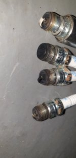

Compressions are good range between 150 and 160 psi hot and cold. Ive rigged up a pressure guage to measure the pressure comming out of the mechanical fuel pump could any one verify what this should be?
Once I've done this il check the timing.
The plugs look like the engine has been running rich

Fuel pump pressure 4 to 8 psi, don't think that's the issue
Checking timing and advance

Yeah fuel pressure was 5.5 psi. I checked timing out of gear. The timing set to 6°btdc at idle and advancing to 23° btdc at 3000rpm.
Im starting to think it might be the Edelbrock carb ( which was new) which is supposed to be matched to the engine but un sure of what the jettings are supposed to be.
Even if the drive had a a lower ratio surely It wouldn't loose 2500rpm
53,310
your mechanical weights may not be not fully traveling. you should be at 28 degrees at 2800-3000 RPM (sticker stating this is on top the vanity cover on the spark arestor). you can bump your base timing to 8 degrees.
already covered the fact that the carb is smaller than the Holley 715 CFM carb that came on the motor originally.
however improperly set carb would limit fuel to the motor. is your float level proper?
do you get full throttle travel of the carb? with motor off, move the throttle forward until it hits the stops. then look at the throttle plates. the fact that you have an edelbrock carb were the holley was most likely you do not have full travel as the carb throttle arms are different lengths. you can adjust the throw of the throttle cable at the helm control by putting the cable in another hole
unless someone swapped the drive, its not the drive. the AQ271C was only paired with the 290DPA

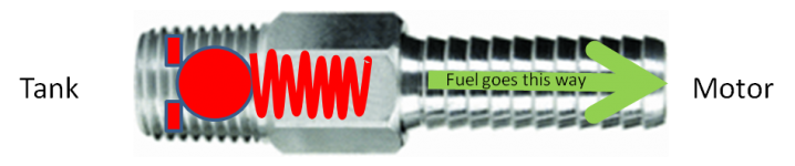

Antisiphon valve on the fuel tank can cause this; had the same problem on my boat a long time ago....
