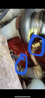

This thing circled in green still has bit of water
Lou C
Nov 10, 2002
14,262
Ok your heat exchanger has 2 sections a closed side that circulates antifreeze to the block and an open side that uses seawater to cool the antifreeze. If you remove the cap that looks like a radiator cap on top of the red housing which is the heat exchanger (let engine cool off!!) there should be antifreeze in there. The part you circled I’m not sure about; I’m not really familiar with these older Volvos. I think you need a manual to make sure the winterization is done right.
