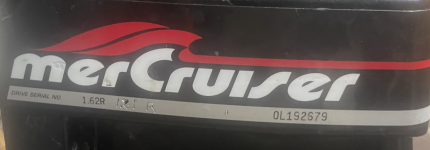

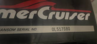

My Drive Info:
Drive SN: 0L192679 (model # 5121300LS)
Transom SN: 0L517680 (model # 611001LS)
SN on original Docs: L430356 (model # 5121400LS)
(not sure why docs are different from drive label; perhaps drive was replaced. dunno)

Being your serail number is 0L517680 which is above 0F094775 you still have ordered an updated design kit that will work just fine as checking over all the parts catalogs, it shows to use 23-806036A1 vs the older design 23-805041A2 that at one point was a new design in both 1991 and 1998.
