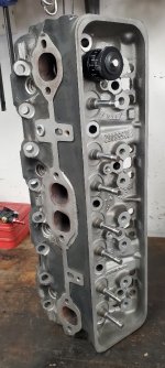

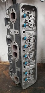

Finally got the cylinder heads back from the machine shop yesterday. They have been there since January.
Now I can start making some progress.

Also got better data...
I installed a new Garmin GPS a couple weeks ago and on a brief test run... saw that the speedo is WAY off.
Last time out... loaded a bit heavy with 75gallons of gas and a 225lb friend.
Dash showed 48mph / 4500RPM
GPS said I was going exactly 42.0mph.
So... I think the 26pitch props will stay on with the new motor. The new motor will run to 5500RPM... so it might be a decent combo.
