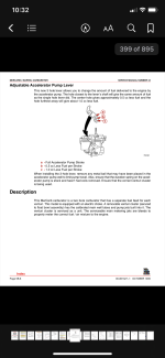

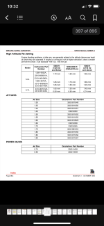

If you have too much pitch that would be the case, but usually to get on plane relatively quickly I'm 2/3-3/4 open throttle, then pull back once on plane. Your WOT RPM will be key- if you are on the low side of your range say 4400 rpm go down to a 19" pitch.
The carb was set up for a 5.0 - the jetting and power valve is the same as in attached file. The venturi is different as it has larger accelerator pump discharge holes on a 5.7. Not to over complicate things but might help to drill out the accelerator pump discharge holes or move the pump arm lever to the closest hole to get a bigger shot (2nd attachment).
