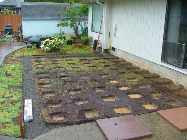

I'll do this post in two parts due to the number of pictures. 8 years ago I tore out wood deck that had been constructed with dougles fir construction left overs. It was originally painted but deteriorated rapidly. By the time I tore it out, it was rotting and sagging.
I explored all the alternatives to replace it but did not like them, either due to the maintanance or the cost. I stumbled on this process while obtaining cultured stone products for a house refresh project.
It was a lot more work than I intended but turned out quite fabulous. The beauty of it was that it only cost about 20% more than an eight year old material bid for a conventional cedar deck.
Hope you enjoy!

In retrospect? It would have taken endless wheelbarrows of backfill. As it was the number of wheelbarrows of dirt I took out for the support blocks and the outer perimeter wall were countless. Lucky I had an old above ground pool depression to dump them in.
For the 5/8 minus gravel alone, to fill the support pad holes and the perimeter trench, took 3 of my little utility trailer loads (1 1/2 yds total) and another countless number of wheel barrow trips to get it to the back.
They delivered 6 pallets of brick and slab and all that had to be hand carted to the back as well.
No doubt it was a lot of work, excluding the perimeter wall, every step was times 70. Dig 70 holes, 140 shovels of 5/8's minus to fill the holes, 70 hits with the monster masher compactor, 70 setting and leveling of the 12 x 12 concrete support pads, measure the height for 70 pipes, cut 70 support pipe pieces....well you get the picture.
Additionally, this patio covers two foundation vents. Backfilling would have blocked them, now they just vent under the slaps.
Eight years ago the bid for conventional cedar deck materials was $1500.oo...Today, my total bill for this deck was just under $2000. The deck is 22' x 13'.
