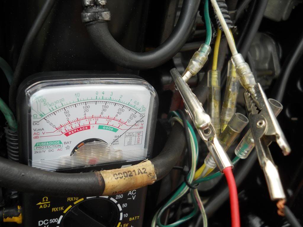

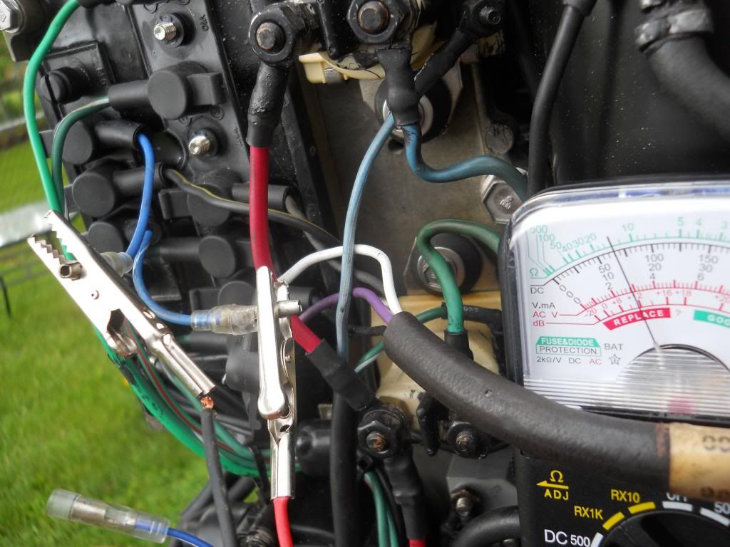

Tests--I just removed blk/yel wire and switchbox and NO spark.
I pulled the grn/wht and wht/grn from the stator and got full continuity is this right?

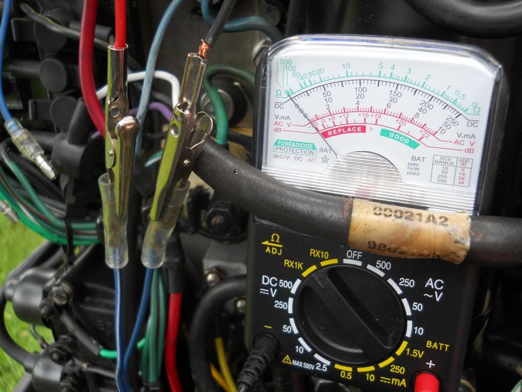

Apparently the original black stators had issues and were replaced with the better "red" stators. There is an "adapter kit" with the red stator. Now after the above stator test I plugged the grn/white wires back in and followed them through the "adapter" and unplugged them at that point (just before switchbox). The wires change from grns/whites going into adapter to blues and whites coming out of adapter. I tested them and found NO continuity at that end. Not sure if the adapter is bad or that is how it should read. Yes the purple and white wires were removed form switchbox just while I was doing other tests. Just wanted to note that have otherwise been hooked up.
bankbuster
Jun 3, 2011
107
Re: 98 Mercury 115 hp starter, battery, solenoid, issues. HELP it wont even start no
These are the two wires that are coming from stator going into switchbox and the reading....and NO, i dont know what im doing but im trying. Just hoping that someone sees something that is definitely not right!

............. I disconnected the blk/ylw wire at switchbox, set meter to RX1K, pos lead to blk/ylw wire and grounded the neg lead. With KEY switch OFF and kill switch to EITHER RUN or OFF.....I get full continuity. With Key ON and kill switch OFF I get continuity. Key ON and kill switch set to RUN I get NO continuity. Is that right? ..............
This is correct, now repeat this test another 25 times as when an ignition switch STARTS to go bad it does not short every time.
This is a 'Ground-to-Kill' switchbox, when the B/Y wire gets grounded, anywhere, spark does not happen.
This is why it is critical that you repeat the test many # of times, to see if it does fail.
Otherwise it is critical that you test immediately when you encounter the 'no spark' condition.
Do NOT attempt to test the B/Y from the switchbox, cranking it is HOT and will bite you!
