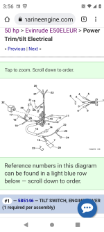

Couldn't find your exact model but number thirty two on the picture is it. Follow the blue and green wires to it location.
Good luck.
