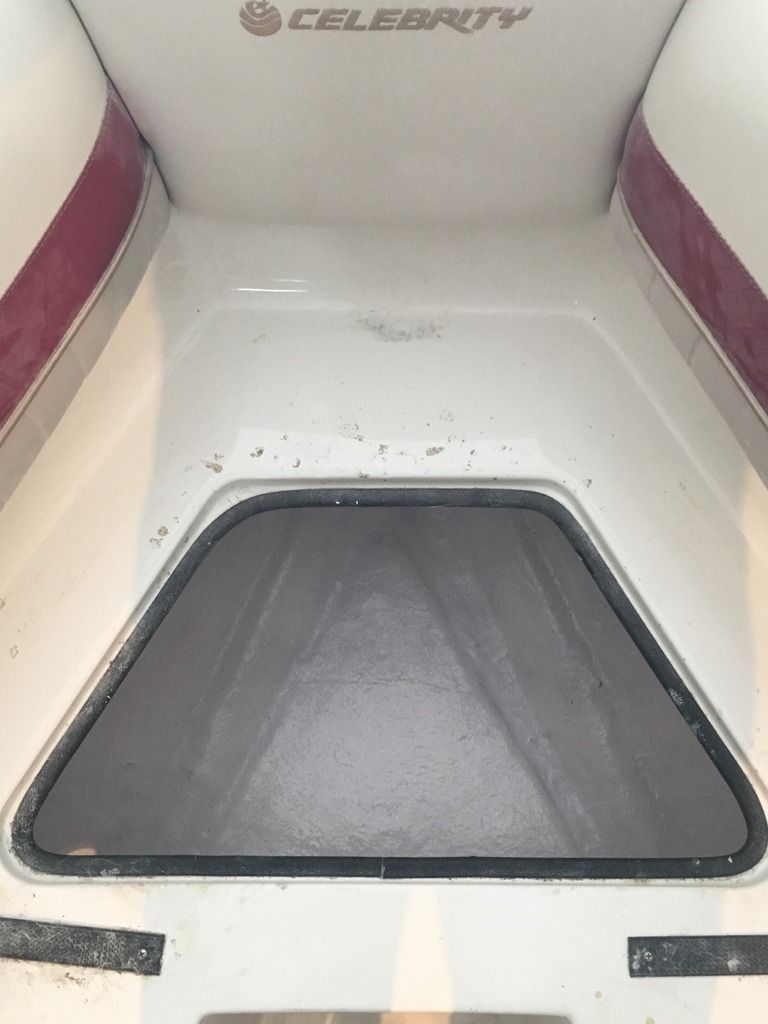

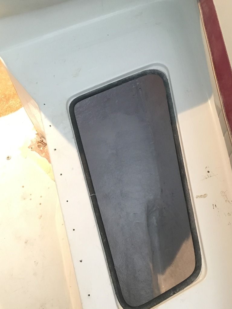

Little update again. I had enough resin left to put down a second layer of csm in the bow area and along the port side of the ski locker. sanded down any high spots and layed down a layer of gelcoat in the bow section. Test fit the ski locker, still need to sand it down a bit more to fit the hinge.

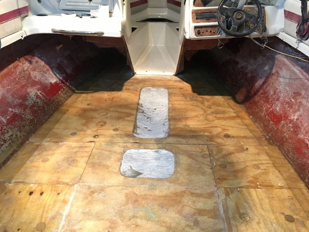

More resin will be here today and will get the rest of the deck done and gel coated this week, also will get mounts glassed in and hopefully be able to test fit the motor this weekend and get the bilge gelled as well

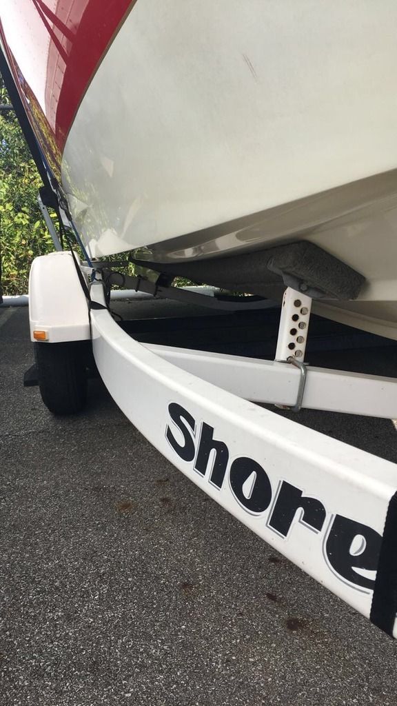

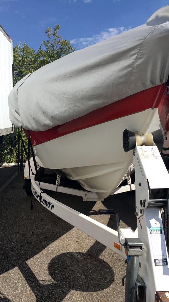

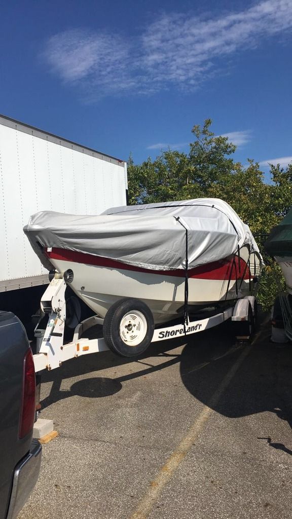

On a side note from my build, I've been wanting to address the issue with my trailer and the way the boat sits on it. The boat seems to be putting a lot of weight on the front keel roller and causing it to split apart/crack the rubber. I just replaced the roller in the summer and it did not last long at all. The bunks are adjusted as high as they go right now. The boat is obviously a 96 and the trailer is a 2000 or 2001. Any advice on what I can do to fix this so I don't ruin he keel on my boat.
Baylinerchuck
Jul 29, 2016
2,740
Yeah I wouldn't like that either. I am not a fan of keel rollers because if the roller fails it's gelcoat on steel. Steel will always be the victor in that battle.
If it were me, I'd buy a different bunk bracket that was higher and get that keel off the roller altogether. Even if you had to add another set of bunks, get the keel off that roller.

I've been looking at adding another set of bunks or adding just a centering v bunk in place of the roller. My bunks are as high as they go currently, so I'll have to see if I can get taller brackets. Although I think these are the tallest ones ahorelander makes, so I'll have to do custom or find another company. The trailer it's self is in great shape, just need to get it set up correctly.
