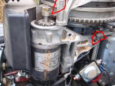

I have taken those two loose but it is still on there tight it seems there is another bolt holding but I cant see it
and these?...

I removed the 2 small ones to the right, I don't have that other bolt. Here is what I have
