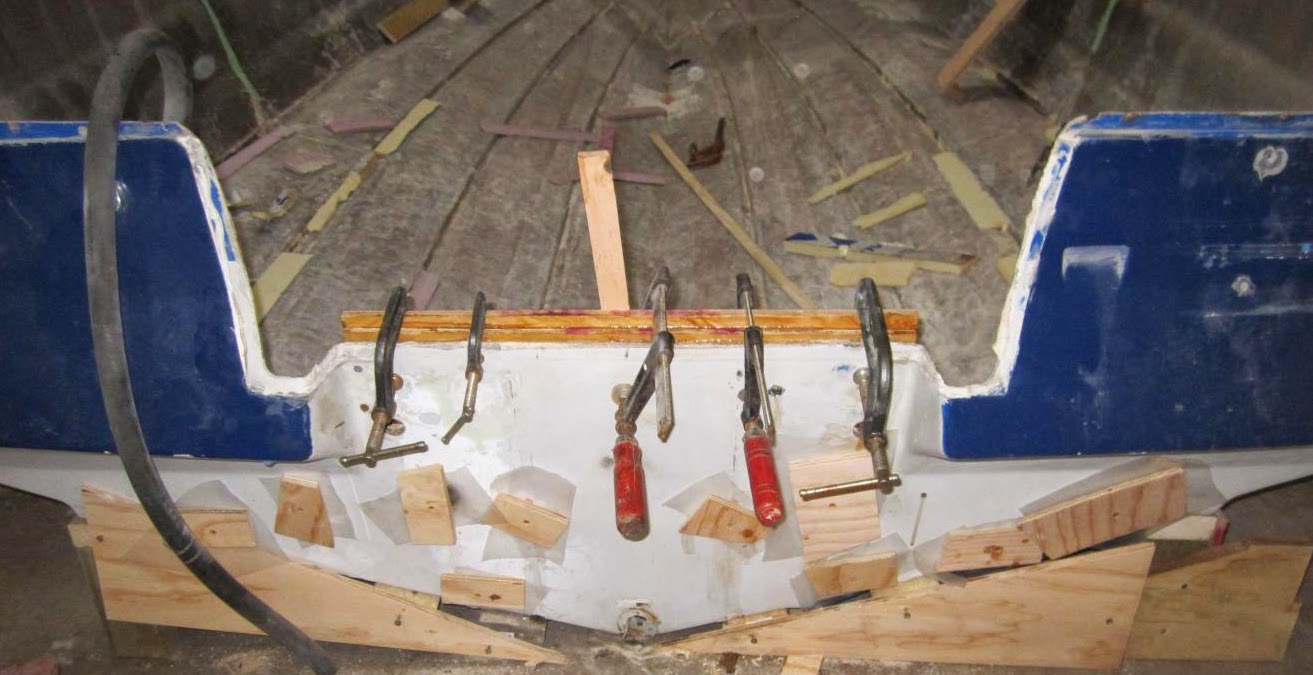

Yesterday I got the third and final layer of the transom in.

I have several small holes drilled through the transom, each with a wood screw pulling the new layer in tight to the previous layer. I use pieces of polyethylene vapour barrier between the hull and the bits of plywood that act as washers for the 3" wood screws. Epoxy doesn't stick to polyethylene, so any squeeze out is separated from the wood.
I find that the green coated deck screws are easy to remove from cured epoxy, but we (Dad) had trouble removing a couple of the brass coated ones we had kicking around for this project.
