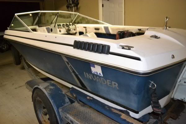

Here are a couple of pictures of the exterior.
Photobucket album:
http://s10.photobucket.com/albums/a150/Pridekit/87 Invader/

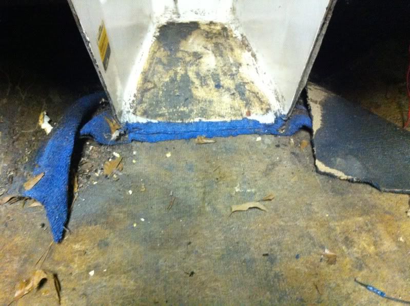

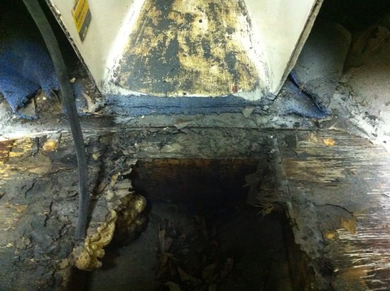

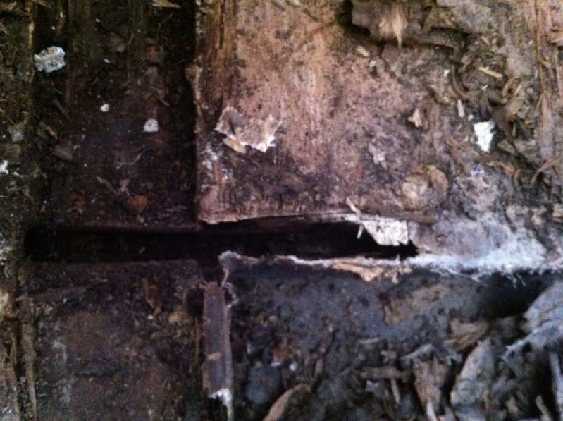

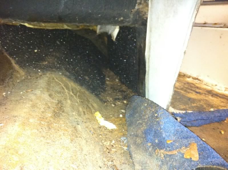

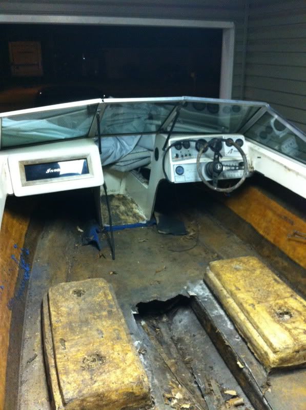

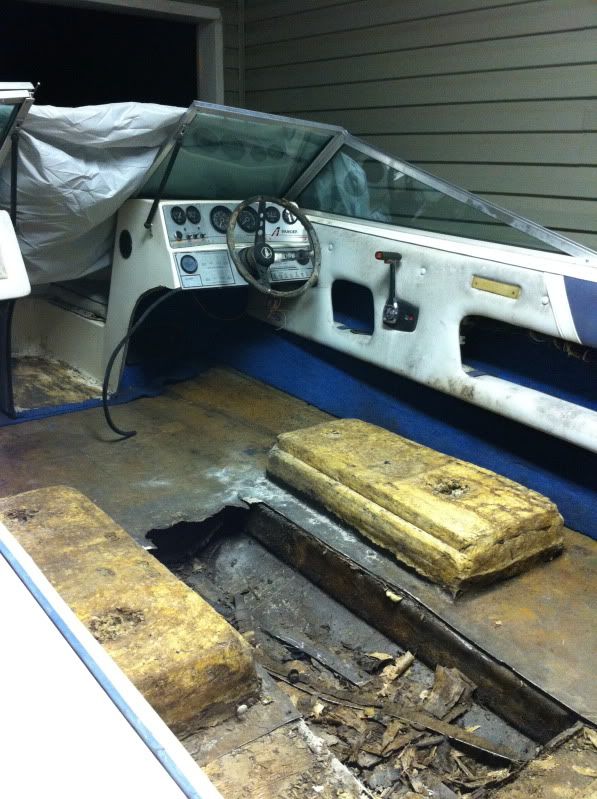

So I took some pictures today.

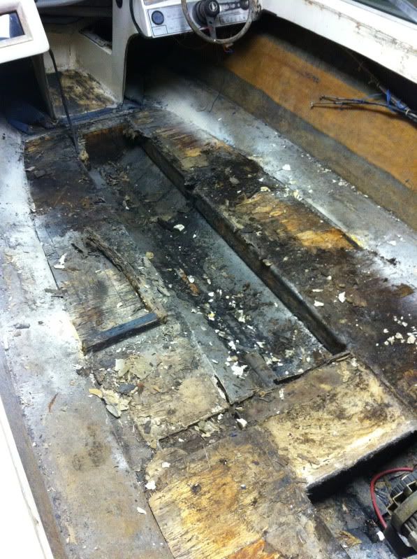

Here is what it looked like after I cut some of the fiberglass out of the floor yesterday
The black slot is where the stringer was

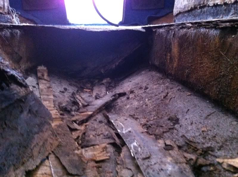

Here's a shot looking down the stringer area
Here's a shot from the ski locker up towards the bow

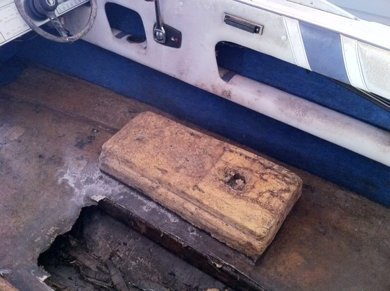

Here is what is left of the ski locker cover
These foamish looking blocks are where the seats used to be (the previous owner threw them out because they had rotted out). I'm not sure if I need to keep these or not, but I know they are fiberglassed to the floor

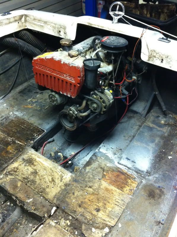

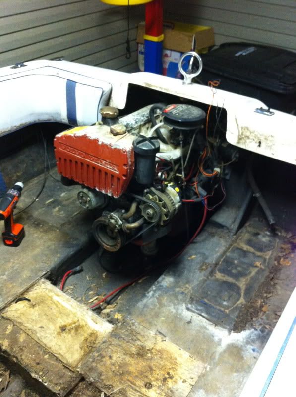

AQ131A / 275, I removed the fuel tank and battery in prep for cutting out the floor
Just a general pick of the inside. How do I remove the throttle control? I'm trying to pull the side panel off so that I can finish pulling out all of the old carpet. I've separated the trim and throttle from the back piece (not really sure what all the parts are called), but I can't figure out how to pull it all out or how they got it in there in the first place.

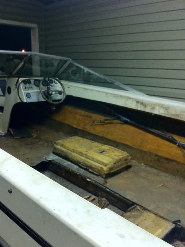

Re: 87 Invader v171
Managed to get the rest of the trim pieces removed, I ended up just cutting the wires for the trim switches on the throttle control. After a bit more searching I found that the trim switches weren't even hooked up (just the one in the instrument panel).
Started pulling out the remaining carpet.
I'm a bit concerned about how I am going to get this section of carpet out.
The white area in the bow is part of the cap. Any suggestion on how to pull that carpet out with out taking the cap off (I may have to do it eventually because I have a gut feeling that the deck and stringers are rotted out all the way through).
Should I yank the black carpet under the bow seats out or just leave it alone?

Re: 87 Invader v171
Have someone help you... Lift up on the dash and the walkthrough should raise up off the deck a bit....then pull hard on the carpet.
If you need to glass under the dash area the black carpet will have to go so you gan grind the old glass and lay new glass... It's a royal PITA to work under there but it can be done....did it on my resto.

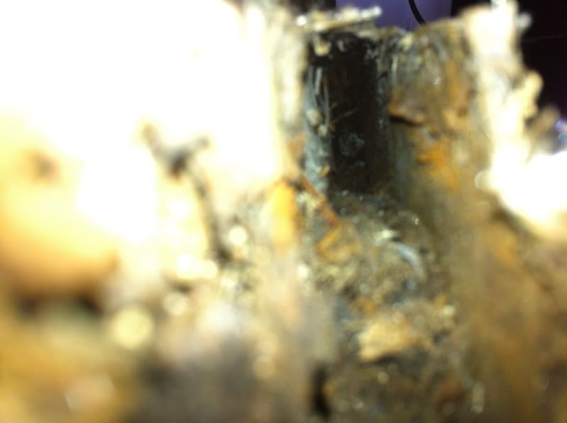

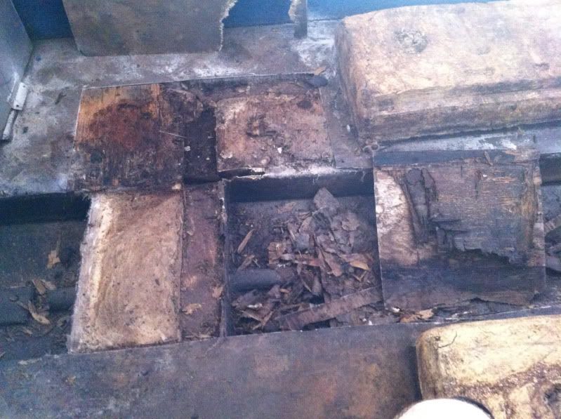

Got rid of most of the fiberglass that was over the wood deck. Pretty much any fiberglass left along the sides is on top of the hull.
The wood near the fuel tank and battery area visually looked OK (compared to the rest), but it was pretty wet so I have a feeling I will need to cut all the way to the back :( I really didn't want to mess with the area that the fuel tank was sitting; its raised up, maybe some wood underneath or something else.
This bow area was really bad. I think I'm going to look into taking the cap off just to make sure I get rid of all of the rot in the bow. It got so bad that I made one wrong step over the ski locker and I went through the floor (and I'm only 130lbs!).
I also confirmed that both stringers are going to have to be replaced for sure. They are practically compost at this point.

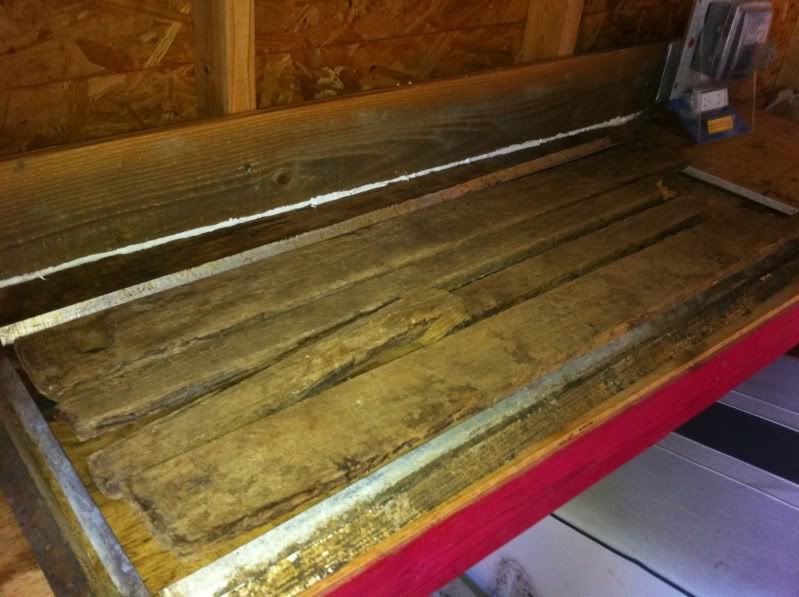

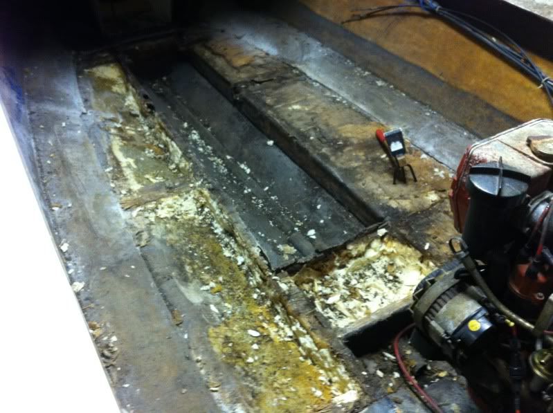

Well I have gotten most of the foam out from one side.
I think I am going to cut out the stringers instead of trying to put new ones in the fiberglass shells.

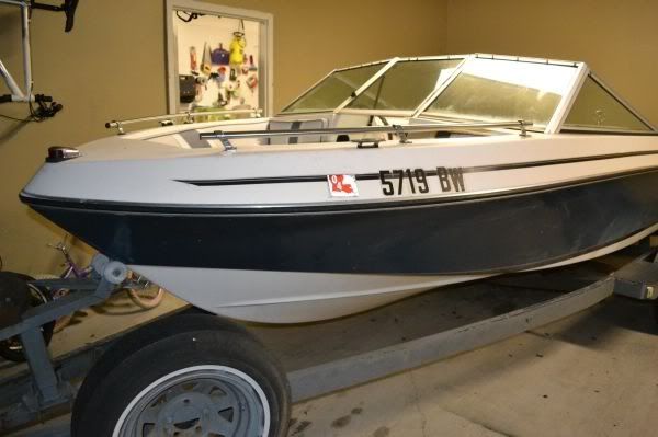

Updated the OP with some exterior pics I should have put up a while ago.
