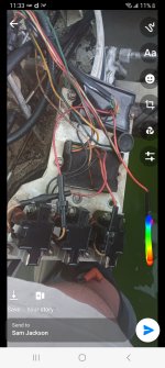

Screenshot_20230530_233336_Messenger.jpgquestion this mod runs num 1 and 2 cylinder. Would the trigger be bad of.the num. 2 cylinder is.still working? Probably a dumb question... also ignore that the highlighted wire is supposed to.go to cylinder. 1 not the wire that's in it...

Yes, the CD module has two channels and one can be bad.
you can swap the CD modules and see if the issue follows or not.

Sorry for the SUPER late up update.received_131403553319135.jpeg but after all that checking and trouble shooting.it all came down to a broken ground connector on this piece the green one on top looks like its on there. But the male tab was actually broken.thank all tou guys for the responses.shes running like a top again.20230612_105507.jpg
