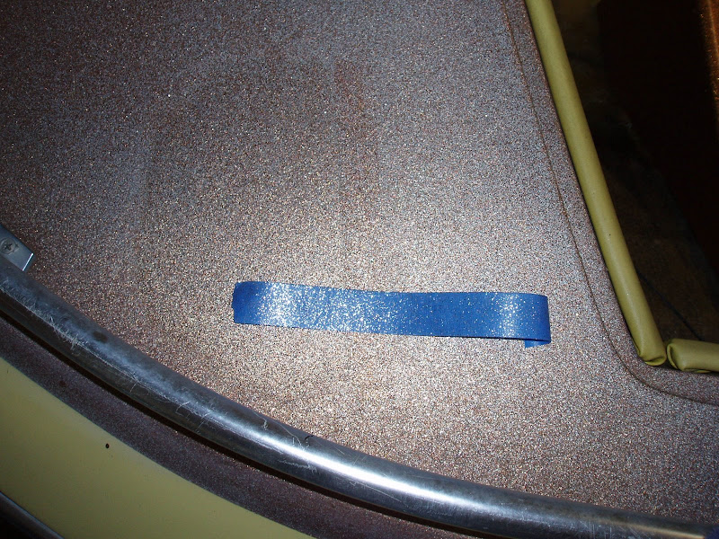

However...my Glastron Carlson CVZ-18 was in exactly the same condition. Here are before & after pictures, and the process I used to bring it back. It'll never be factory perfect without serious coin...but it is possible.
For the record, I could run my hand on the finish and would have metal flakes on my hands...it was sandpaper and very rough. Tore a foam pad up before I started over with sandpaper.
Before:
I could pull flake off with tape...it was baked...and shot...
