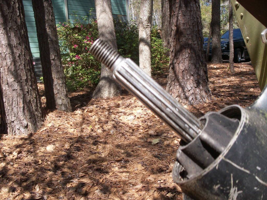

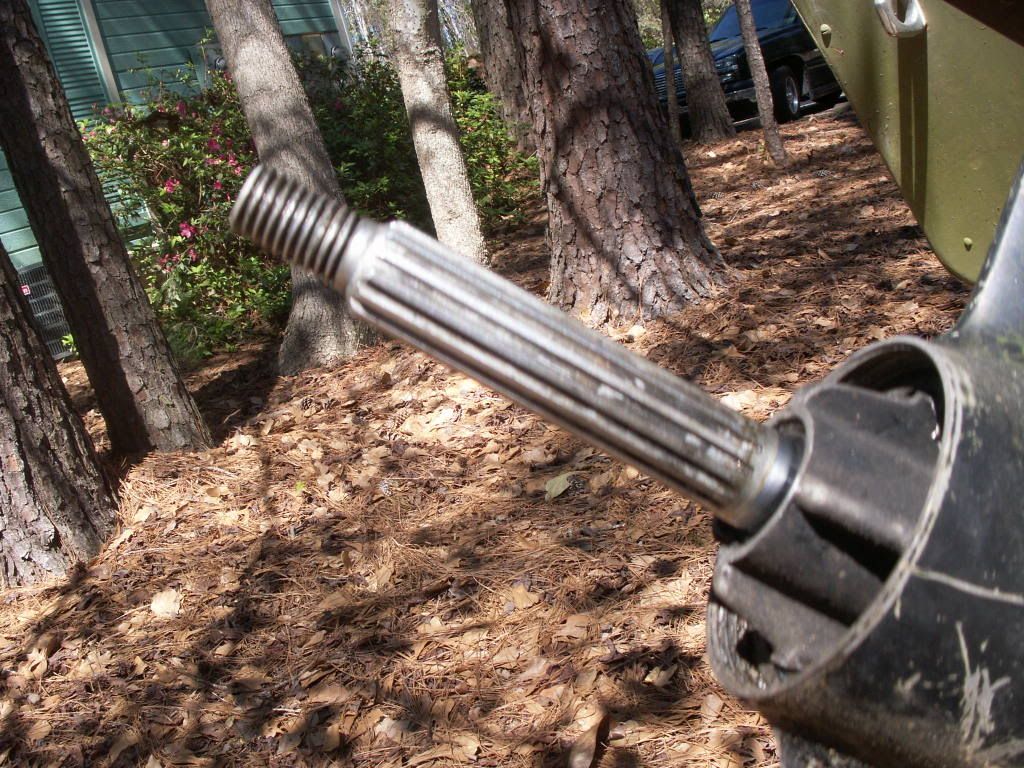

It won't go into gear, after I put the new prop on. Looks like I am missing a piece maybe. The shaft slides in and out likes its not connecting with something it should be? Any help would be greatly appreciated..

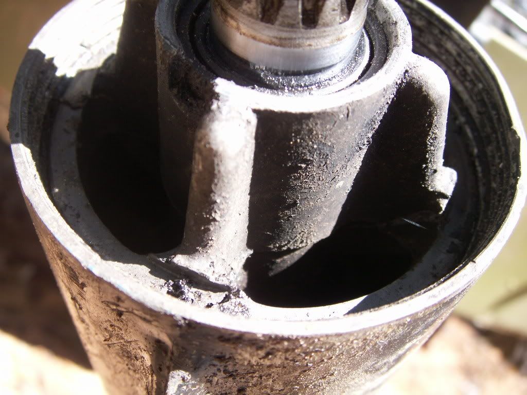

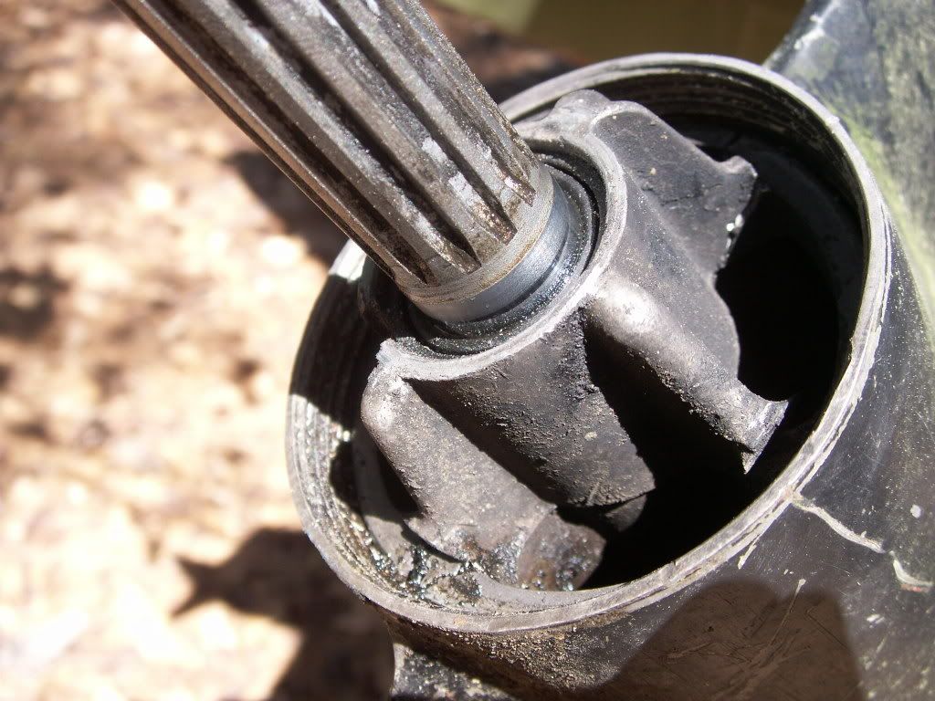

Prop seems to stick out far. I looked inside and it looks like it is split on the inside edges in 2 places and the shaft moves in and out about an inch or so. Neighbor thinks its busted and its time for another one.

Prop shaft should not move in/out that much. Sounds like you may have a busted bearing carrier, or even worse a split gear case.
Happen to have any pics of the area just behind the prop, where you say it is "split"?

It is busted...

Yup...you're bearing carrier is toast. Hopefully that mark along the outside of the case is just a scrape, and not a crack.
You can take that gearcase to a shop for rebuild. They should be able to replace the bearings, seals, and bearing carrier for you for a reasonable amount. Have them check the prop shaft for straightness, and inspect the gears and shift cam while they are in there.
