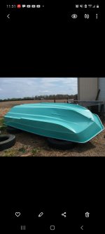

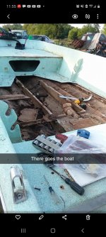

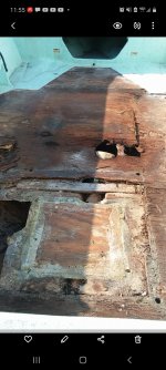

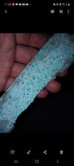

To start out, let me explain what I'm doing. Last summer I began restoring my 73 fiberglass lucraft boat. Really heavy and well build, just abused and wood was rotten. So I began a full rebuild. The only thing that concerned me was the inside deck. It had a zolatone/splatter paint look. It was a blue green backing with white and bright blue splatter. Looked good imo and provide enough traction while still being easy to clean and durable. I would really like to have that redone in the same fashion.

I have been unable to find zolatone paint. Or atleast colors I like. I've been reading alot about using webbing in smaller concentrations to give it that splatter look. Ive read of using reg paint to splatter with say a brush, but i know thats not going to be as durable especially and since im trying to blend it.. There are just a few things I want to clear up.

Thanks everyone, here are a few pictures just in case you are curious. I used to have better ones that had more post teardown but the new transoms is in there with the splahgauard I decided to do instead of the aluminum ones it had. The others must have been on my old phone
