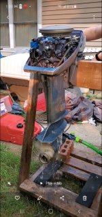

I have a 1976 9.9 evinrude , it was running rough but it was running she was finicky but we knew what she liked to get her going (full choke for a few pulls until she sputters then half choke a few pulls then no choke ) , it decided it only wanted to start in gear last year this year we did an oil change and new spark plugs but we couldn't figure out the only wanting to run in gear issue , so i brought it to a small motor repair guy and when we got it back it wasn't running at all! anymore he claimed to have done a tune up and tried to tell us it wont start because its sucking water into the gas system but we dont believe that to be true the guy sonic cleaned the carb so its clean and before giving it to him. We ran it with a high sea foam consecration to clean out the system , The spark plugs fire and jump a 1cm gap and it has compression my boyfriend keeps reading stuff hoping we can figure it out because we really do like our 9.9 its perfect for our small aluminum car topper boat so we hope to get it running again . (We bought a 6hp johnson seahorse as a holy crap we have 3 days until we go camping but she just doesn't have the power we are use too) pictures is part of a video we made to send to the small engine guy of it running .
This is our engine

Does spark jump a 1/4" air gap? What is your compression? Points clean and set correctly?

I wanted to get the most accurate answer for you so the Boyfriend says the compression is low 90's , as for the gap jump we went out at 11pm and noticed the one coil was not sparking properly!!! The small motor repair guy replaced a working coil that had a crack with a second hand coil that was obviously older and now we know its not working properly so thats one mystery solved , We connected the original coil that he had removed and got a beautiful spark on both coils i even moved it back probably an inch + before i caught the spark ! As for the clean points and being set correctly he read about that today so we have to look into it more . We are going to see if she will start tomorrow its to late to try today .

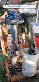

Today after work my boyfriend swapped the used replaced coil for the one the guy took off and guess what ... SHE IS RUNNING ! Not super smooth and she still needs 4-15 pulls but im excited she is running because the guy who tried to fix it told me to sell it for parts then offered to buy it . As for how she is running now ... i wish i could upload a video but she seems to be getting stuck at high rpm's when throttled and doesn't come down when you lower the throttle boyfriend describes it as being sluggish going up or down in rpm's but shes basically back to how she was before the guy "tried to fix her" i can't even believe all the stuff this guy said was wrong with it from sucking water up with the gas and needing a new gasket, the coils under the fly wheel, that this motor was mass market built like crap can't get parts and how i should get rid of it and get something else 😡

"sluggish"... would that be in neutral? it has an overrev protection mechanism in neutral so you cannot get it to rev past 1/3 throttle or so. the hard starting , after everything has checked out, is most certainly due to worn piston rings, making it impossible for the motor to suck in a large enough fuel/air charge.
