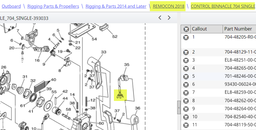

This is an old 704 binnacle, that has individual leads instead of a plug for the harness, and it has decided it no longer wants to trim up. I can swap the green and blue leads in the harness and use the toggle in the down position to trim the engine up. I think this means the fault is in the switch or contacts, but it looks to be encased in epoxy.
Is there a fix for this switch or should I just buy a new binnacle and get a harness side plug to match it? If I need a new binnacle is this the harness side plug Ill need to avoid splicing wires?

I am not following you. All of the trim and tilt switches used in Yamaha 704 control boxes have bullet connectors for the three individual wires.
Jprevat
Apr 25, 2016
321
Ohhh I definitely didn't know that. Every wire under my dash is a bullet connector so I assumed the plug on the 704 pictures I saw was a revision of that setup.
I'll go ahead and order a new switch.
Thank you very much
