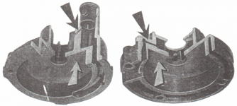

If after spinning the drive shaft as suggested by Crosbyman water doesn't flow upward with a nice flow check the hidden vertical water passage located under the water pump's base which extends to the lower leg's cavity. Pic is just a reference....
Being a 63 year oldie expect to find some passage reduction which needs to be impeccable clean for the water pump to suck and pump a much better amount of water towards the powerhead.
If still with overheating issues, remove the thermostat if counts with one, bolt lid back on and connect a garden hose with proper fittings to the middle leg's lower water pick up tube, flush it for as long as you want.
If the issue continues and there's no anode inside the powerhead that might been clogged over time, that motor has already accumulated large quantities of scale inside all their narrowed cooling water passages which needs to be taken care flushing a descaler fluid which should be the fastest way to have the motor in full operation shortly after...

I took Sea Rider's advice. Opened up the plate below the water pump (didn't do that before) and found some gunk but not what I would consider to block any flow. Cleaned it out completely including the underside of the pump plate. Checked passages in the leg with wire and pouring water. They are very clear to begin with but tested them anyway. Hooked the shaft up to a drill with the lower unit submerged. No flow out the top at all. I re-opened the lower unit thinking maybe the key at the impeller is sheared at the base and I missed it. The key was fine. This whole thing has me puzzled. All in all this motor was used very little and in fresh water (it was a duck hunters motor). I'm no genius but I've worked on many other motors and never had a problem like this with a cooling system. Thanks again for all the help.
