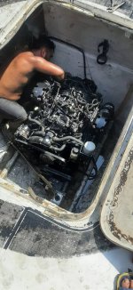

Hello friends, we also have problem with 5.7 liter that the engine revs up to 4,500, 5,000 when stationary, but it does not increase to 2,000 while moving, and the oil pressure is not constant and it plays constantly.

What is the motors serial number?
Does the motor start easy but just won't increase above 2000 when in gear?
Have you done a compression test?
What is the fuel pressure reading?

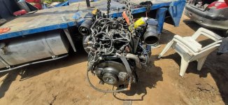

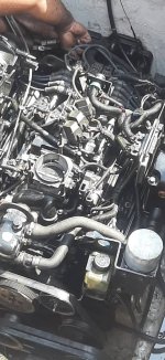

I still don't know what exact motor your working on. This is why I've asked for the serial number. It appears to be MPI from the pic with a 555 ECM but there have been a few different mods happen over the years

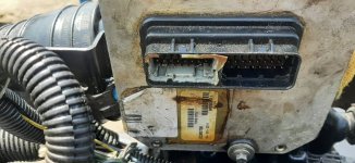

Thanks for number 2a014494
The ECM looks rough with the connector coming apart

Next thing would find out if there are any codes in the ECM. It will need to be scanned
Have you done a compression test and if so are they in the 150 psi range 1030 kPa

There should be a plug cloe by the ECM and probably has a black cap on it, maybe 2 in wide.
There it is next to the engne connector

You will need a Rinda scanner to read the codes. Can get the handheld Techmate Pro or software that runs on a laptop. Both will require adapter 94006. The ECM cannot be scanned with meters or other OBD scanners
The software is $599.00 kit 94010 which comes with 2 adapters, the one needed and for older models
The Techmate Pro is $499.00 kit 94706 and comes with adapter needed
