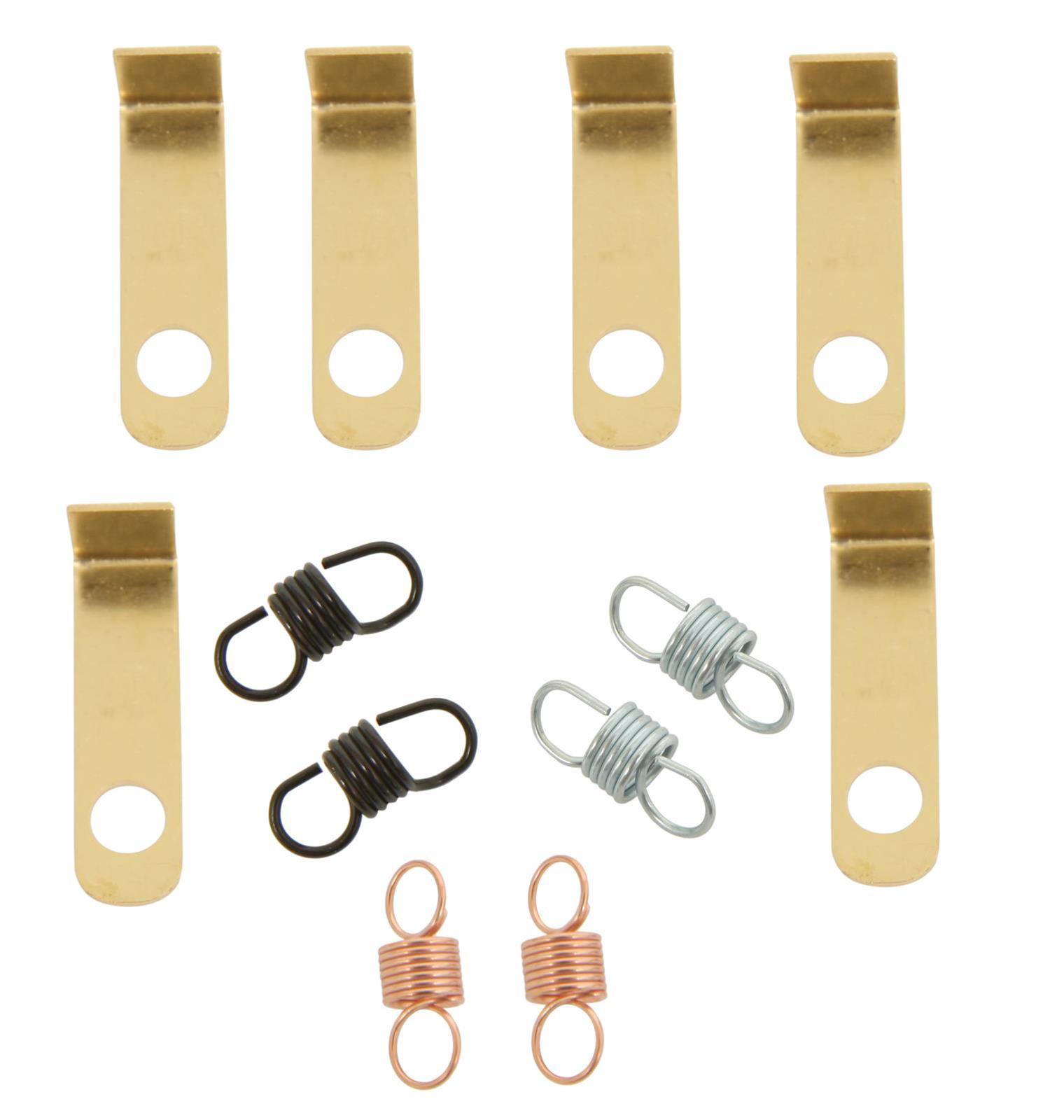

The kit has several sets of springs. Currently, the centrifugal advance is over advancing. Either tighter springs or something to limit the advance would be the likely solution. For $15 it seems like a reasonable thing to try. As I mentioned earlier I can't find any documentation or replacement parts (nor a parts diagram) of the current distributor so I need to experiment.
you cant use springs from one manufacturer and expect them to work on another manufacturers distributor and expect them to work. only way to "experiment" is with a sunnen distributor machine.
