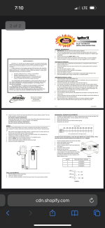

Current distributor is a mechanical advance and was designed to only advance 12 degrees from idle timing making total advance 18 degrees when idle is timed to spec of 6 degrees.IMG_3259.jpeg
