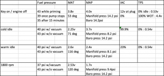

Fuel pressure should be 43 psi at 1800 rpm
With key ON, what are the fuel pressure, TPS, MAP, IAC and battery volt readings when cold?
With key ON, does the fuel pressure drop off hold or slowly drop?
With motor cold and running what are the TPS, MAP and IAC readings when cold?
After motor is warmed up what are the readings and battery volts at or above 1800 rpm?
Fuel pressure reading when vacuum line is removed from regulator?

So when I did a compression check on a cold engine my readings were about 160, the 185 was with a warm engine and the throttle wide open. It may not be the most accurate gauge, but all readings were within a few psi of each other.
Battery voltage at the battery was 12.5v (brand new battery). With the engine running, it was 14.4 at the battery with my meter and showing 14.2 on the techmate. I did notice the block pressure is showing 12.1psi with the engine off and when it is running it reads 13.5psi (not sure if that would cause anything or not). I did a cylinder drop test and they all had the same effect, so that leads me to believe all cylinders are firing. I am not sure of the spark table for this, but at idle it is still firing after TDC. At 1200rpm it is 4 BTDC, 1800rpm is 13 BTDC and will go up to 28 degrees maximum. The manifold vacuum at idle is still right around 11-12"HG (which I would expect to see around 17-18). At about 1000 rpm if I just barely move the throttle , the engine will stumble and run erratically and the timing will jump back and forth between 10 degrees before and 10 degress after, its all over the place. If I increase or decrease the throttle just a little bit (by tapping on the throttle plate with my finger, so it is barely moving) it will smooth out.

The IAC should never see 99% othen then for s split second, and agree your vacuum is low. Fuel pressure is low, so either the regulator is weak or the injectors are leaking
