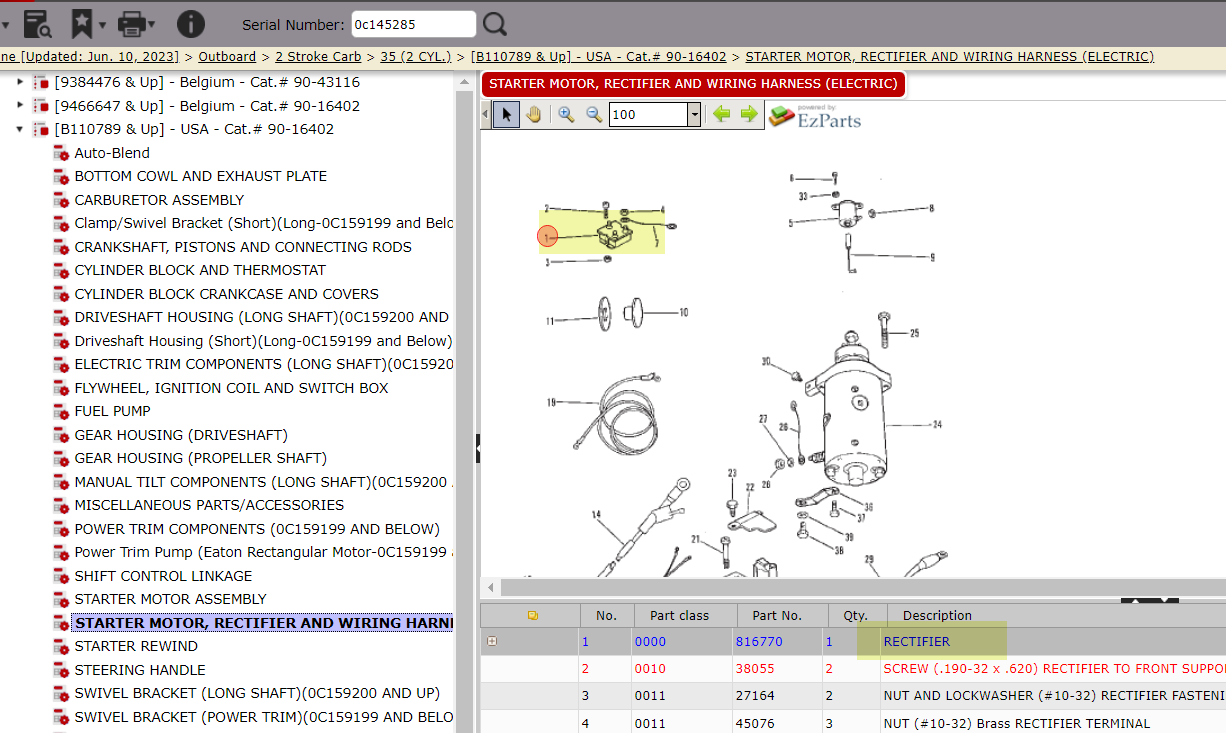

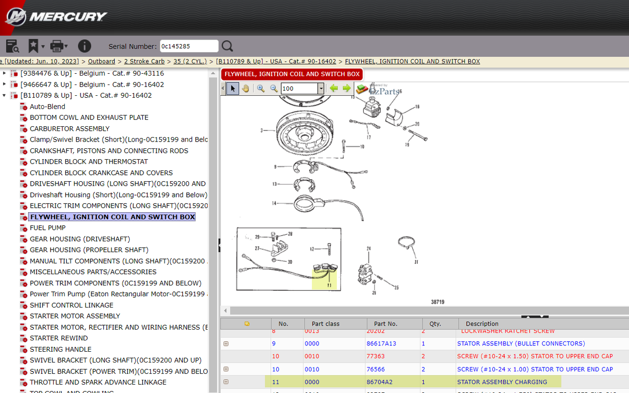

Select the USA version and it will take you to the parts catalog for your motor. You can then view the page showing you the flywheel (induces voltage in the charging stator) and the stator itself, and then the page that depicts the rectifier.

Thanks @boscoe99 . The parts pages certainly indicate this should be capable of charging:
