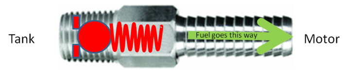

The antisiphon valve is connected to the top of tank and has a barbed fitting which the rubber fuel line connects that goes to the fuel filter/pump
If you can start and it runs fine at first even at high speeds and then starts loosing power over some time. Can shut it down for a while and then can do it all over again, its probably the tank vent
If it stays at low power from the get go, then look at the antisiphon valve, filter and fuel pump

Is it the same as the check valve coming out of the tank and going directly into the line to the fuel pump?

I put a small hand transfer pump on the fitting and used it to drain the tank. It took very little effort. So the valve could work as designed and fail to work at times? Next time it happens I will park the boat for an hour and if it then works it is probably the check valve? Correct? Then the question is how to get the check valve off the fitting without snapping it. Buy a boat they said, “It will be fun”

If it takes a while before it happens its not the valve
When it happens, stop the motor. Go to the gas cap and get your ear close to the gas cap, then open the cap. If you hear air suck in then its the tank vent line, might be clogged
